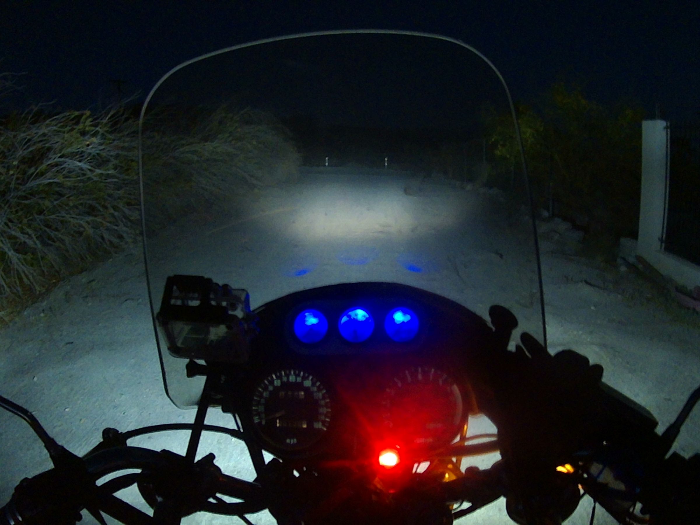

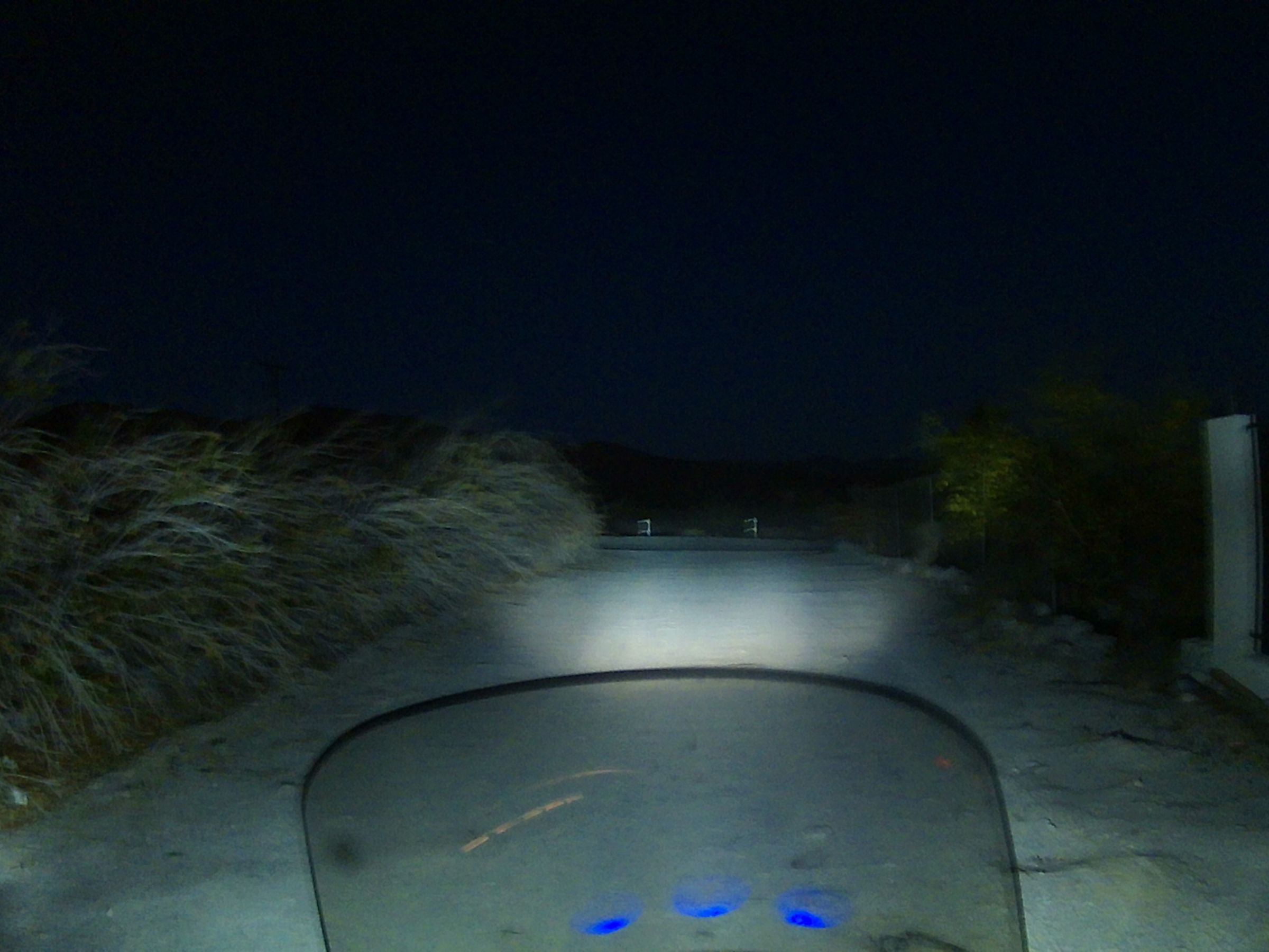

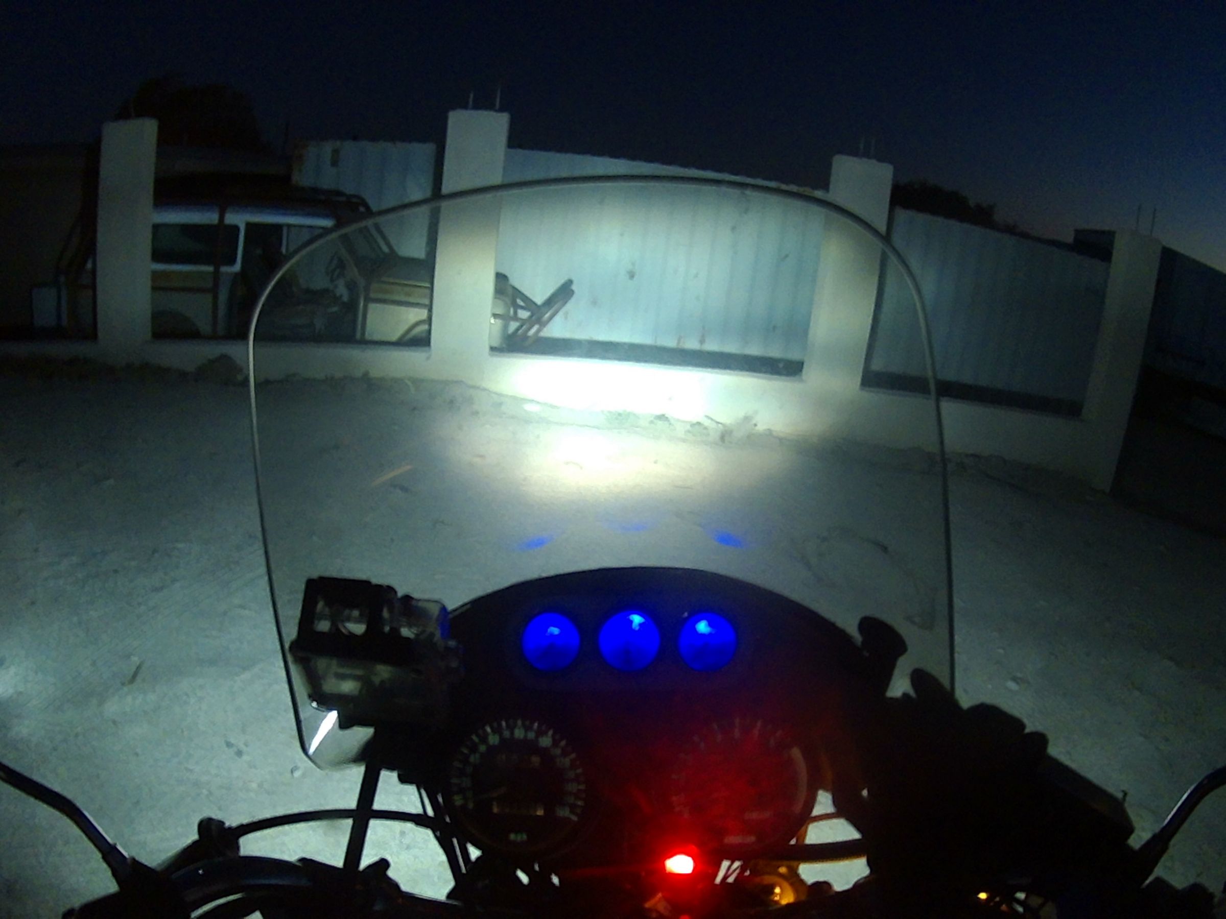

No eBay APP ID and/or Cert ID defined in Kunena configurationI switched to a H4 unit. That allowed me to go with a HID unit. It is brighter, takes less juice, and has a blue tint. I can tell it;s more noticable to other drivers too. Somehow a normal bulb doesn't register to them but when they see the blue, I can see the car come to a complete stop when it looked like it was going to roll through the stop. It happens every day.

The HID has a wide light that is cut off at the top. Great side vision.

Do the ballasts n stuff fit inside the headlight bucket or did you have to do some finagling? Thanks.
Edit: if you installed a motorcycle lens unit & H4 bulb previously, the HID beam pattern could be wide additionally because of the lens unit, not just the HID itself.

It has a small remote ballast and plenty of cable. Order the relay too. It's free. I didn't know I needed it so the sent me one no charge. I love it.

Thanks for the pics. cool. Did you get the lightning blue? If I was to make the conversion, that's the color I'm leaning towards. blue, but not too blue. hee.

I got the light blue. It was supposed to be white but by the nature of the bulb it has a blue tint. I was pleasantly surprised.It came with a pig tail for another light so I cut it off and have been using the wire on other things. Good wire too.
