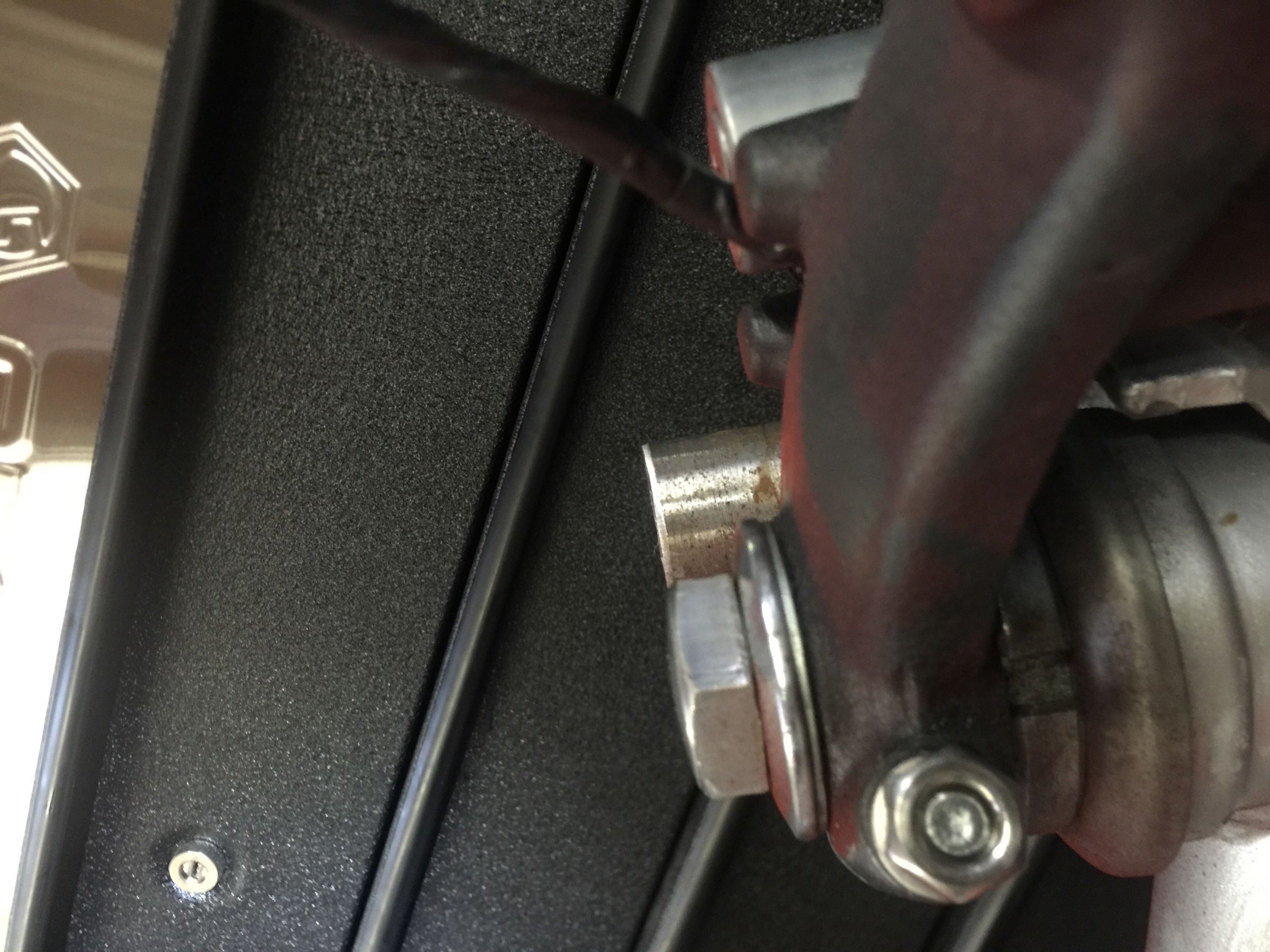

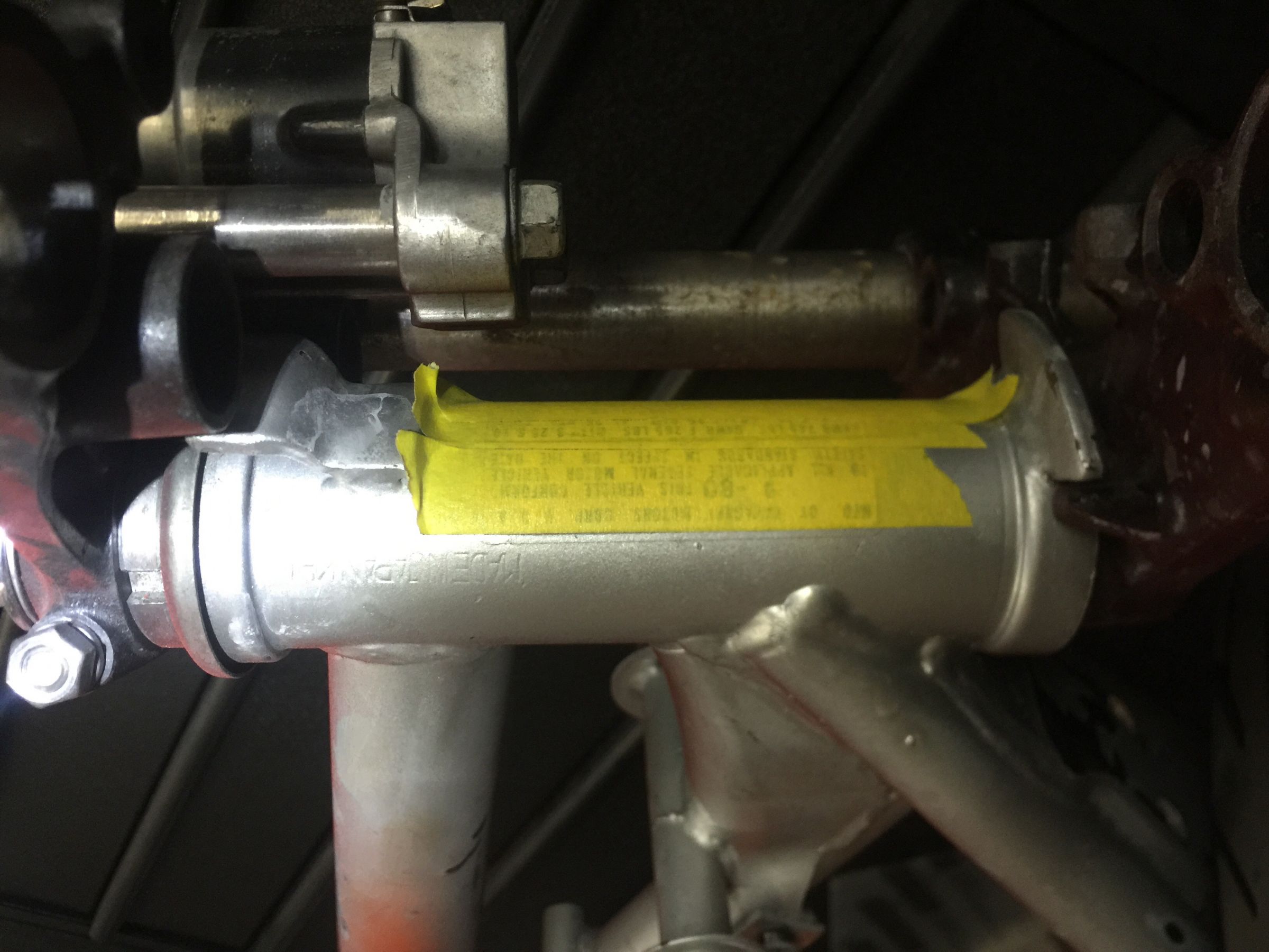

thank guys. All great ideas, I actually had the same thought as you GPZ(love your avatar btw)but the thought of having another key on my ring was nipping at me. Went the spacer route and lowered the ignition 2". The lock out tab would just need to be spun 180, but I'm just gonna weld an 1/8" plate that has a slight curve where it's needed. Hopefully I won't burn the VIN sticker just below. I'll post pics in a bit.

I've learned in the past that Tig'ing and water within close proximity of eachother do not go well together :pinch: So now I've got 18g aluminum sheets of varying sizes that have that aluminized heat shielding material on one side, as well as that heavy itchy fiberglas infused mig welding blanket cut into smaller pieces. Since my bike is down right now, I've got it torn down to the frame so I'm taking this opportunity to address some things cosmetically and change a few others.
Here's how low I've got it now.
How close my VIN sticker(under the green tape) is to what needs to be welded.
