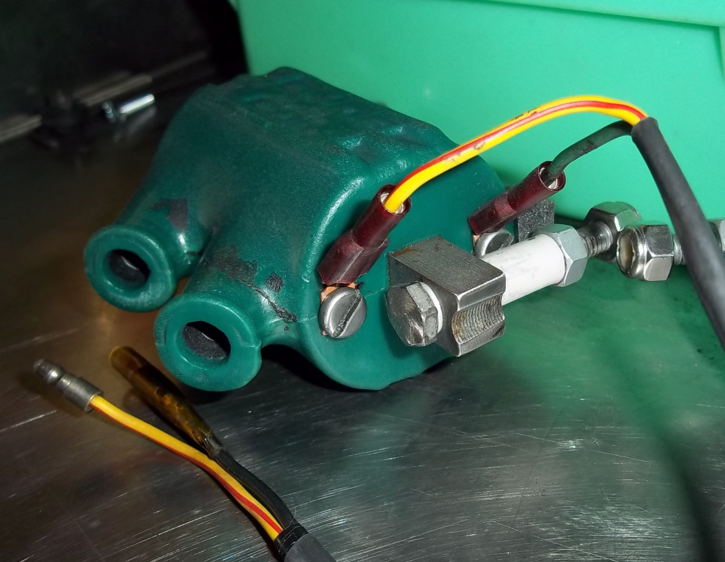

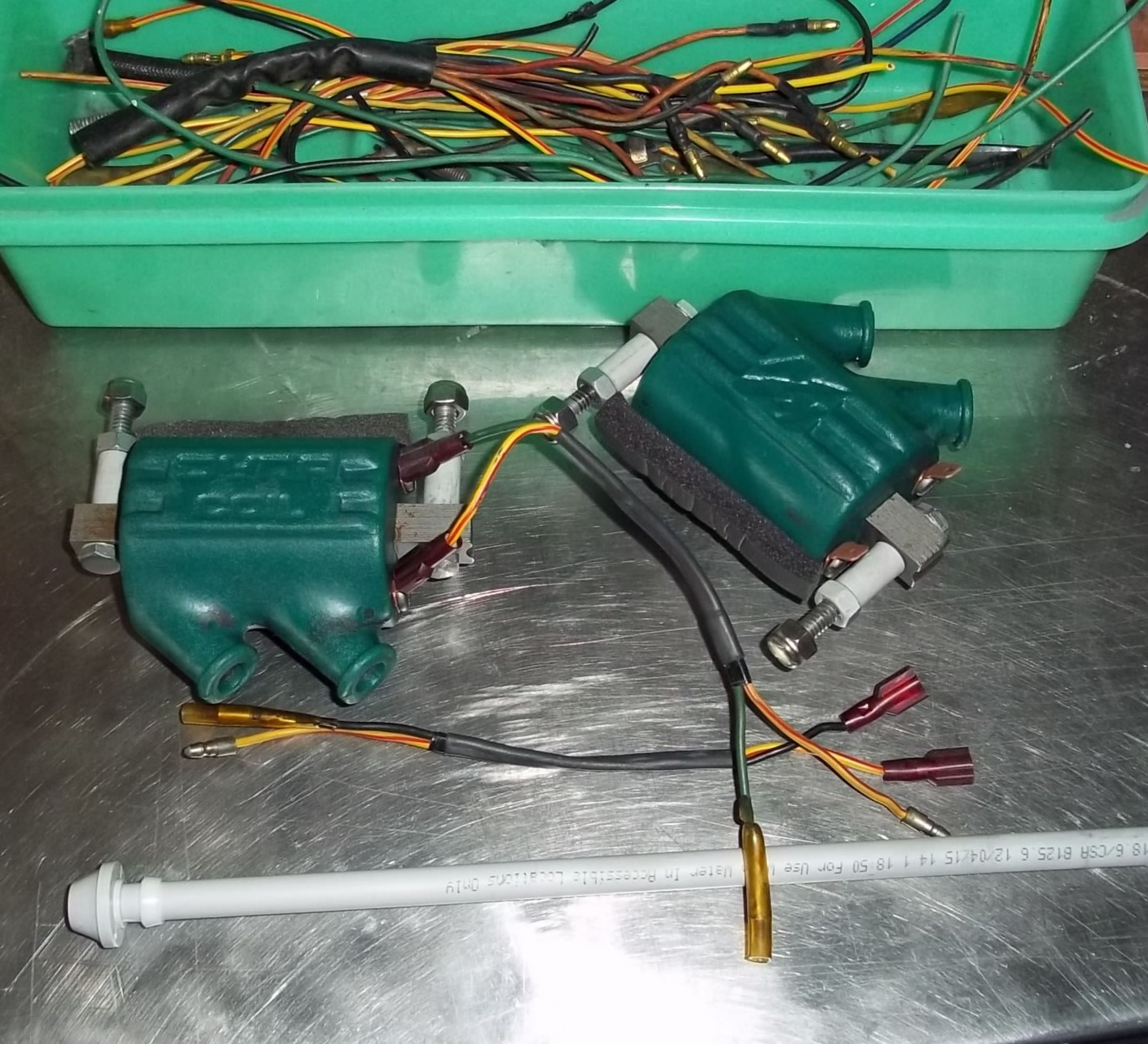

I know its been asked before. But here is a quick easy fix for mounting the DYNA 3 coils on a Kawasaki KZ 900 & Z1
ALSO? the positive 12V terminals? Are they on the top side with the spark plug terminals??? I forgot 15 years ago!
But I used gray "PEX" water line for sink and toilet. $2.49 at Hom Dep. I just cut pieces a little longer than the stock brass pieces.
Also changed the 6mm screws for 1/4" SAE bolts, a bit more snug with no play. Used copper spade terminals.
Now just plug them on. I also put a piece of foam insulation were they would lie on the frame. Used Ny-lok nuts to tighten at frame.
Should work fine for my use's. Couple of pictures.

No eBay APP ID and/or Cert ID defined in Kunena configurationI just mounted mine on my KZ650 with Nylon spacers
I used two 25mm ones with one of them sanded down to around 10mm for the perfect fit.

I use the metal ones for heat transfer. I just wrap the one next to the terminal with electrical tape.
