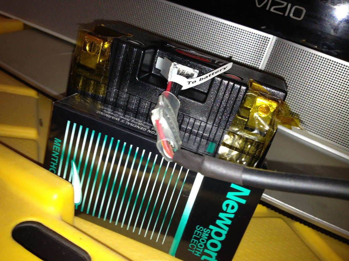

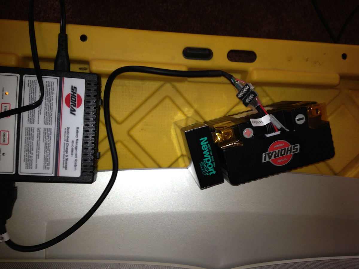

The Shorai LI-ION batteries are tiny, I can be mounted in any position, sideways, even upside down , but they are pricey & need a special charger
They are as tall as a pack of 100's cig's
& are as wide as a pack of cig's
& only weight 1 & 3/4 #'s
Pete
Pete

If you do use a Lithium (Shorai or other) battery be sure your bike's electrical system is up to snuff. Ed
