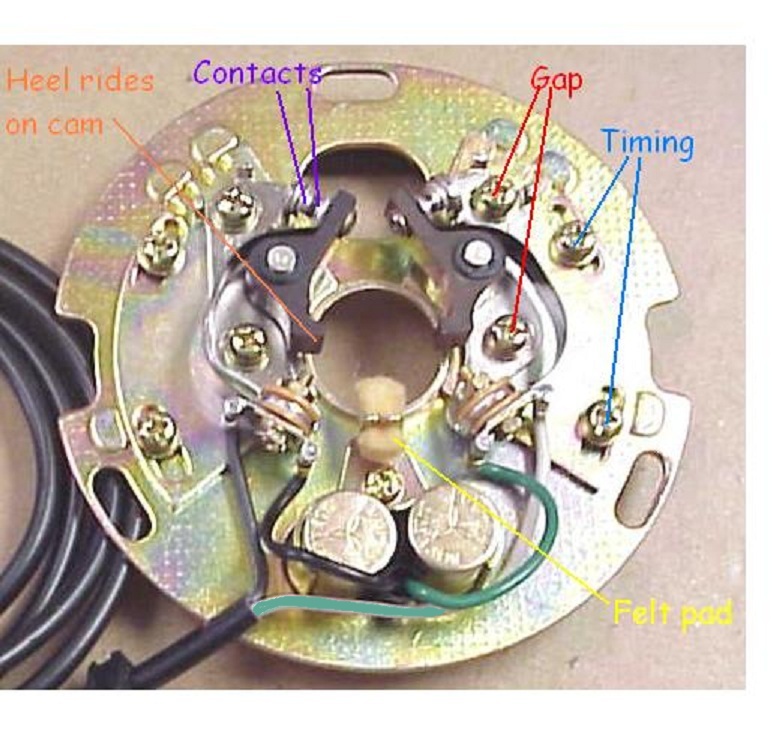

On the 1977 KZ1000, loosen the 2 timing screws on the adjusting plate and use a screwdriver in the pry points to initiate separation of the contacts as the F-mark aligns with the case mark.
If the adjusting plate (held by 2 timing screws) will not travel far enough to allow correct timing adjustment, loosen the 3 screws holding the mounting plate and rotate the mounting plate to provide more room for adjustment of the 2 screw adjusting plate.
The adjusting plate (2 screws and pry points) is the means for fine adjustment of timing.
The mounting plate aka backing plate with 3 screws in 3 elongated holes may be rotated as a means toward getting closer to alignment of the F-mark. But final timing F-mark alignment is best done with the pry points for the 2 screw adjusting plate after the 3 screw mounting plate has been locked down into a position whereby the pry points may be used to achieve the finest timing F-mark alignment.
In other words, rotation of the 3 screw mounting/backing plate is to provide a position whereby the 2 screw adjusting plate may be used to achieve F mark alignment as the contacts begin to separate.

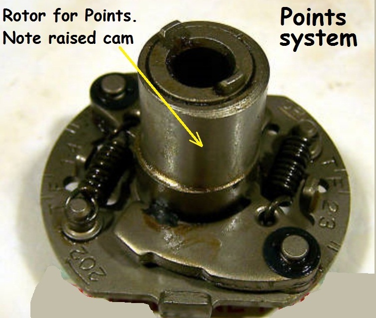

So I pulled the ignition advancer and one thing I can tell you is the the cam lobe of the advancer has a lot of grooves in it that you can feel with your finger even though they appear as not being too deep.
My assumption is that this advancer is to worn down to much to make the timing adjustment correctly.

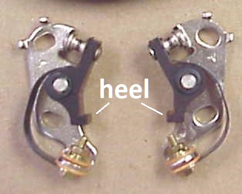

Perhaps the heels on the points have worn down past serviceable condition.
Edit -- I just noticed that the points at hand are new.
I'm not familiar with Daichi points.
Maybe they are the wrong points for this application?
Are the old points available for visual comparison?
I could be wrong, but don't suspect lobe wear as being the culprit.
The following pics are for illustration only, and probably not an exact match of the stock parts at hand.
