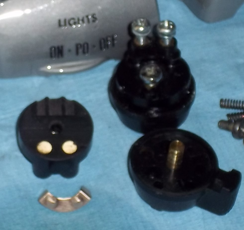

Make sure you take the kill knob off and clean that! All your power runs thru 2 little brass 1/8" round connections!
The following user(s) said Thank You: jertho

The springs are usually gummed up.

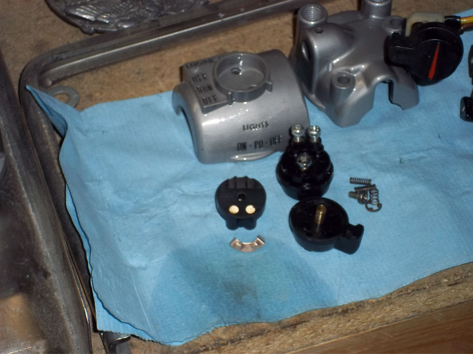

Thanks for the pictures of the kill switch. It's always nice to know what your getting into.
