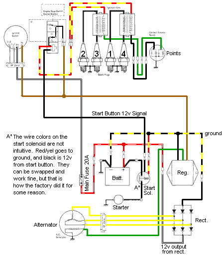

Hi I came here because I ran out of options and this seems like the best place to ask. so long story short I bought this bike not to long ago off an older guy at work ... he attempted to put a Dyna s electronic ignition on the bike and had no idea how to hook it up and I'm guessing he ran into many problems because it looks like he hacked away at the wiring harness. the bike won't turn over, the starter doesn't make any noise when I push the start button and te brake light and blinkers dont work. I'm not too worried about the blinkers and brake light because I can wire those easy from experience on some cars... I've been trying to get this thing to turn over at all and I'm coming here for any tips. I followed this diagram .. thank you any help is appreciated.

28 Jan 2016 07:43 - 28 Jan 2016 10:04Skyliner34life wrote: Hi I came here because I ran out of options and this seems like the best place to ask. so long story short I bought this bike not to long ago off an older guy at work ... he attempted to put a Dyna s electronic ignition on the bike and had no idea how to hook it up and I'm guessing he ran into many problems because it looks like he hacked away at the wiring harness. the bike won't turn over, the starter doesn't make any noise when I push the start button and te brake light and blinkers dont work. I'm not too worried about the blinkers and brake light because I can wire those easy from experience on some cars... I've been trying to get this thing to turn over at all and I'm coming here for any tips. I followed this diagram .. thank you any help is appreciated.
Attachment image.jpeg not found
This diagram will never get the starter to turn. There is no path for power to the relay windings.
As is, that diagram has no direct connection from battery ground to regulator ground. That could damage the regulator. And since the regulator is grounded through the start relay, in that diagram, the starter could kick on while riding.
I'll try to clean it up.

Yeah. I'm glad I spent 2 hours making that drawing. :laugh:
