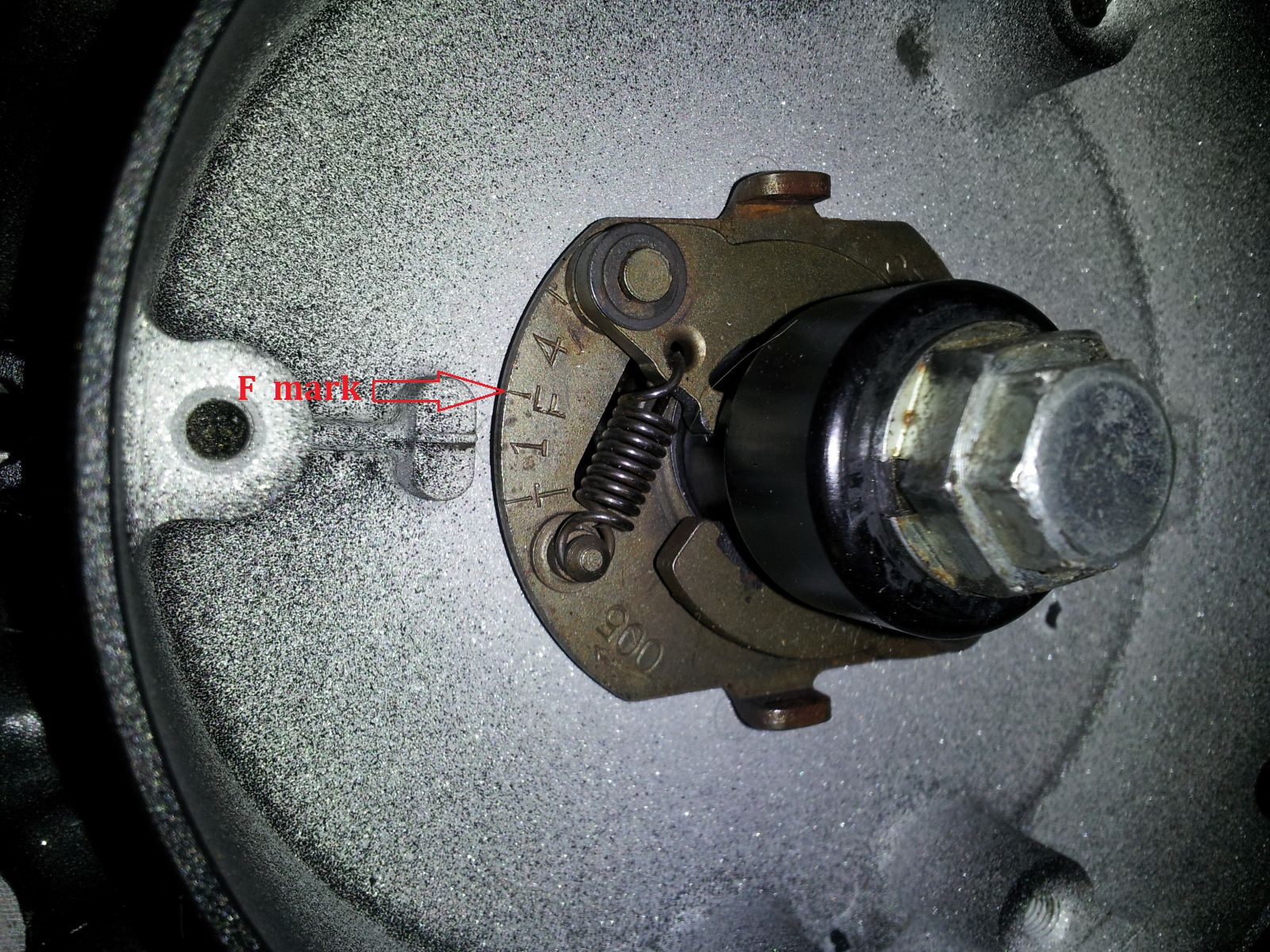

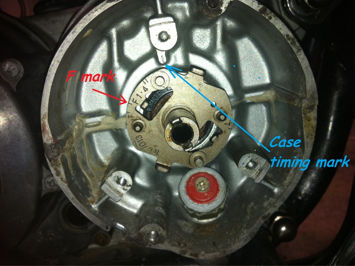

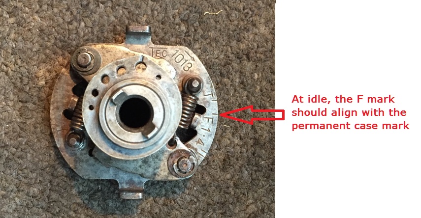

The F mark is supposed to align with the permanent case mark at idle rpm.
The F mark may appear in various ways.
Here are some examples of how the F mark may appear:

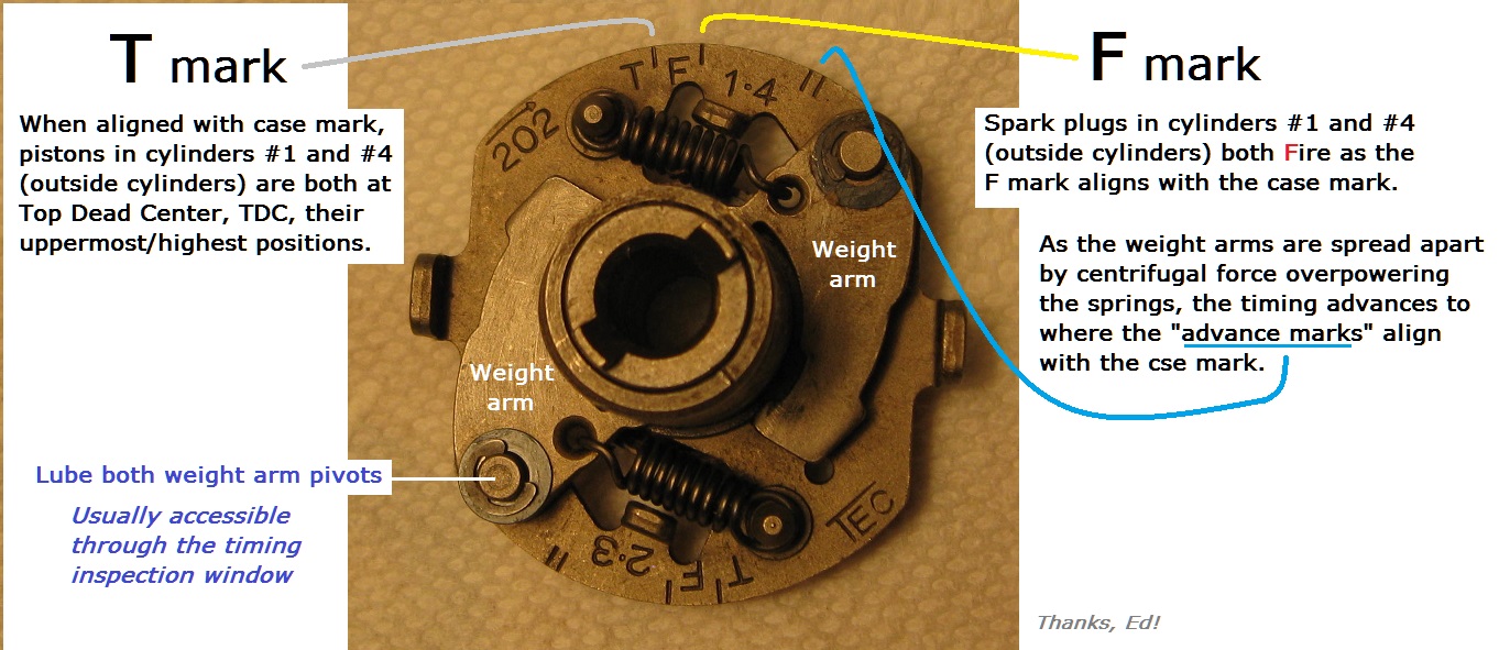

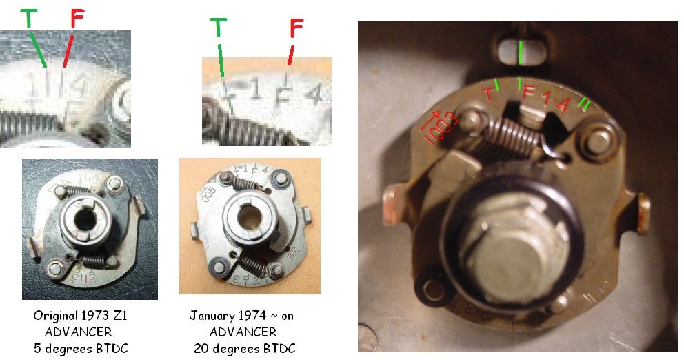

The T mark stands for "Top Dead Center" and when the T mark aligns with the permanent case mark, the pistons are at their highest positions inside the combustion chamber.
The T mark is NOT used for spark/ignition timing.
Only the F mark is used for spark/ignition timing.
Among other things, the T mark is used in connection with cam timing. which has to do with opening and closing of the valves.
