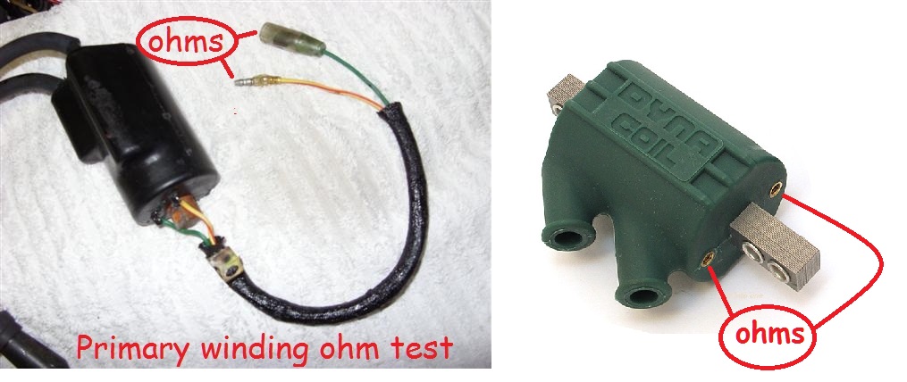

Does ohms rating of new coils match stock?

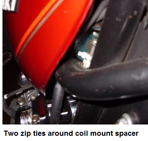

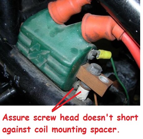

Coil mount issue (possible short?)
