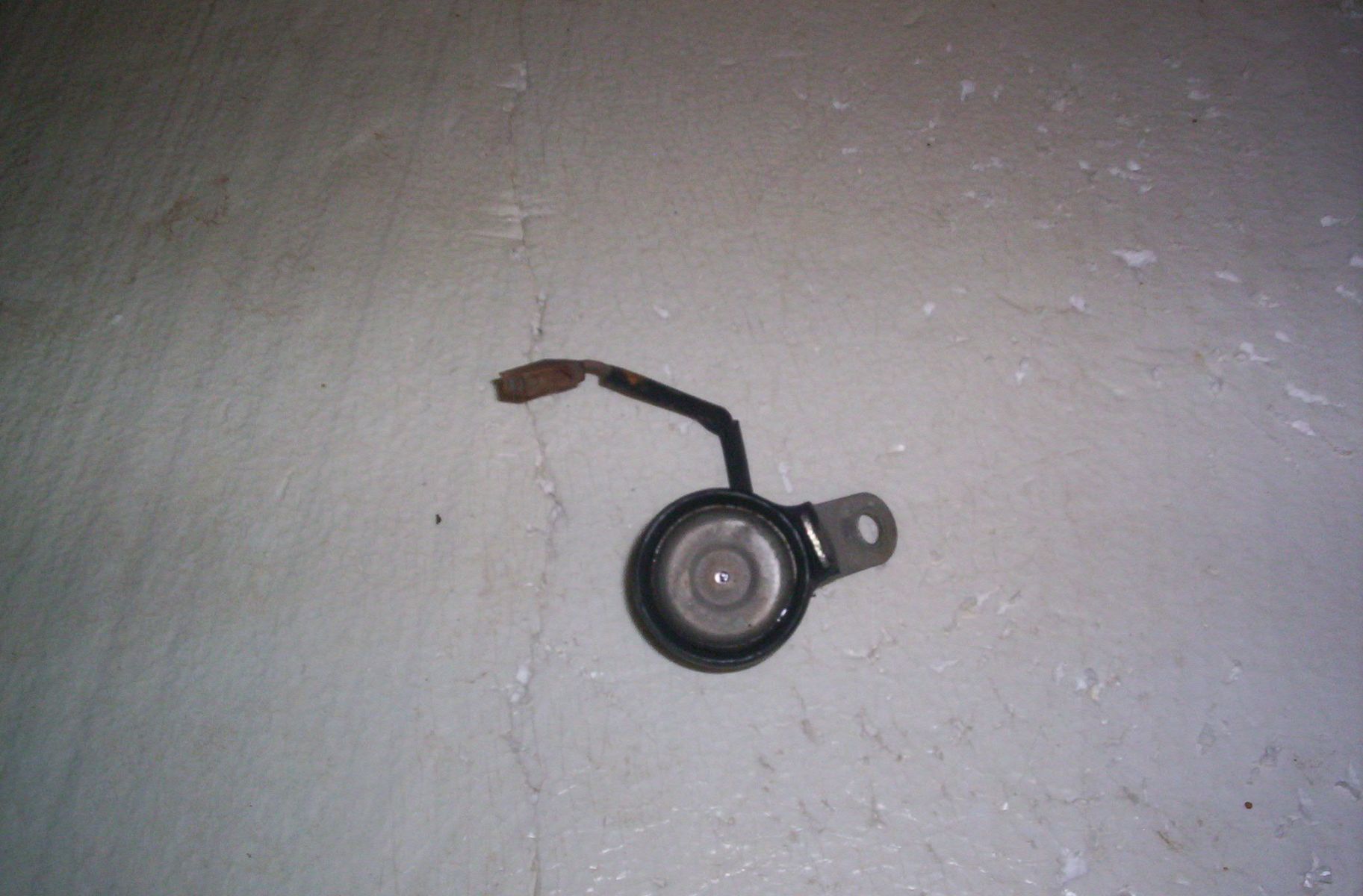

From the looks of your avatar it appears to be a KZ750 twin. I don't have enough experience with them to be able to tell what year but I do know that the 750 twins and the KZ 400s had a lot in common. Some of the KZ400s, not sure what years specifically but I know that my 76 KZ400 D did, came with a turn signal buzzer/alarm. On the KZ400 it is located somewhere around the triples, behind the headlight if I remember correctly. I would guess that it would be in about the same place on the 750. On the 400 it has an orange and a brown wire going to it. You can check the wiring diagram for your model to see if it came with a turn signal alarm and what color wires lead to it. If you're not a fan of the alarm you can simply disconnect the wires and remove the alarm. Make sure to cap off the end of the wires so the loose wires don't cause a short.

I had one. When it got wet it made a pathetic sound, kinda gurgling. I took it back off. It didn't come on the Z1, being I was using a modified KZ 900 loom, I thought I'd try it. STUPID

The turn signal beeper came standard on many models, It's to help you to remember to turn the signal off after you've made you're turn
