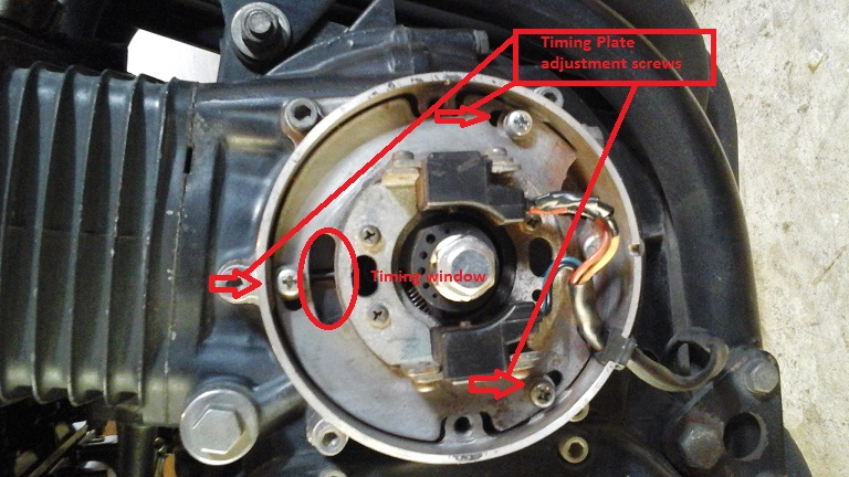

Here's a pic of my ign... does it look rignt?

Looks to me like it's fully adjusted all the way... also kinda looks old and stock. It's a 1980 idk if it came stock with electronic ign.. is there any way I can test this? I have a light but idk what in looking for and what to adjust to...

There are 3 screws that allow you to move the timing adjustment plate. Use a timing light on the window. Your manual covers this if you have one. If you don't get one, for your safety and the longevity of the bike.

Am I wanting the timing mark to be right in the middle of the window while running?

Does the piece with the dots on it advance at all... seems to stay in the same place with the light on it when I Rev it up. But the mechanical advance behind it moves... here's a pic with light on kinda looks like there's a crack on the pickup to the right..
