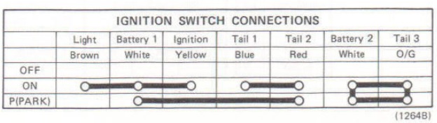

Before you look at replacement switch check also for good connections at the battery and earth, the main fuse and there is a big connector in the headlight shell which connects to the ignition switch. The wiring diagram in your manual (check also the filebase here) will have a small diagram/table like the one below showing ignition switch connection (at the large connector in the headlight shell) and you will need a multimeter to check for continuity/resistance
