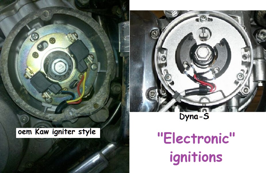

The electronic ignition at hand -- that replaced the stock points ignition -- could be a Dyna-S (a common choice) or perhaps from a later model's factory igniter style electronic ignition, or it might be some other brand of aftermarket electronic ignition.
It's important to use ignition coils that match the particular electronic ignition at hand.
A picture of the ignition at hand would be helpful.

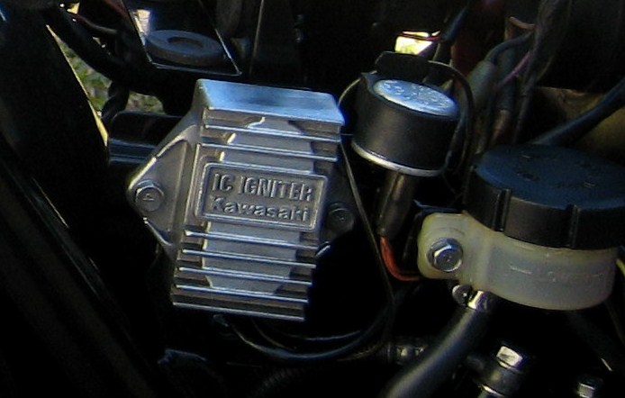

Here's a comparison between a stock igniter ignition style ignition and an aftermarket Dyna-S ignition.
The igniter style also uses a separate Igniter unit located underneath a side cover, which probably looks something like this:
I would imagine that more points replacements are done with Dyna-S ignitions than are done with later model factory igniter style ignitions.
