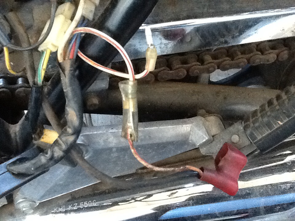

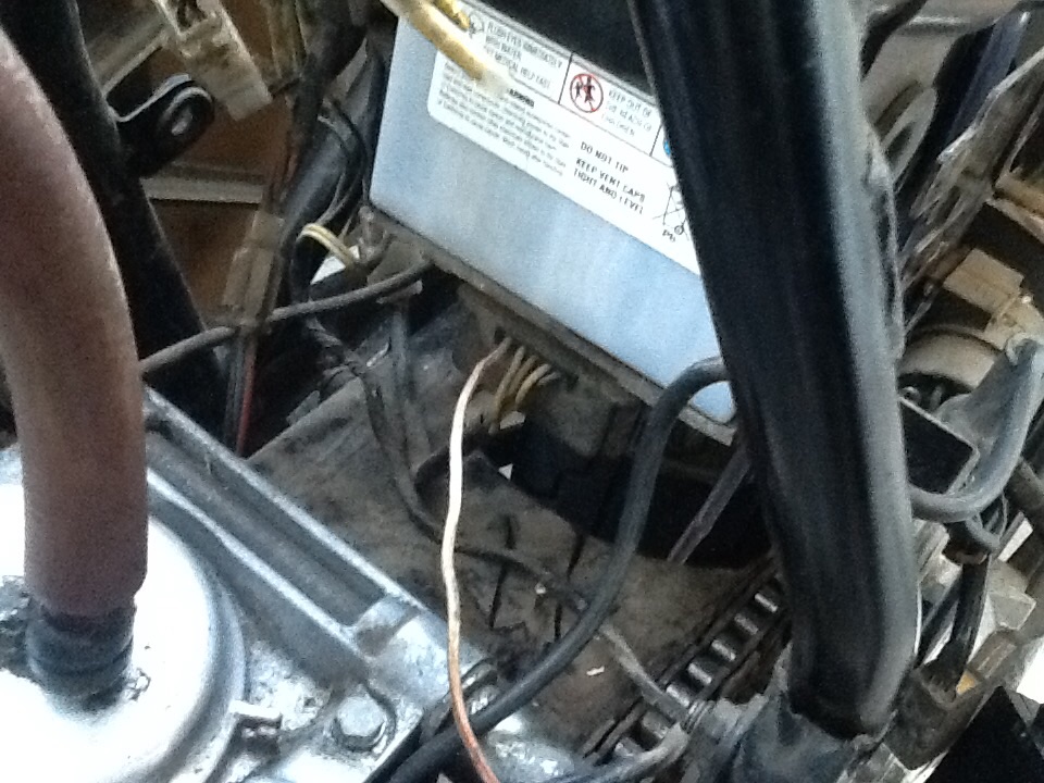

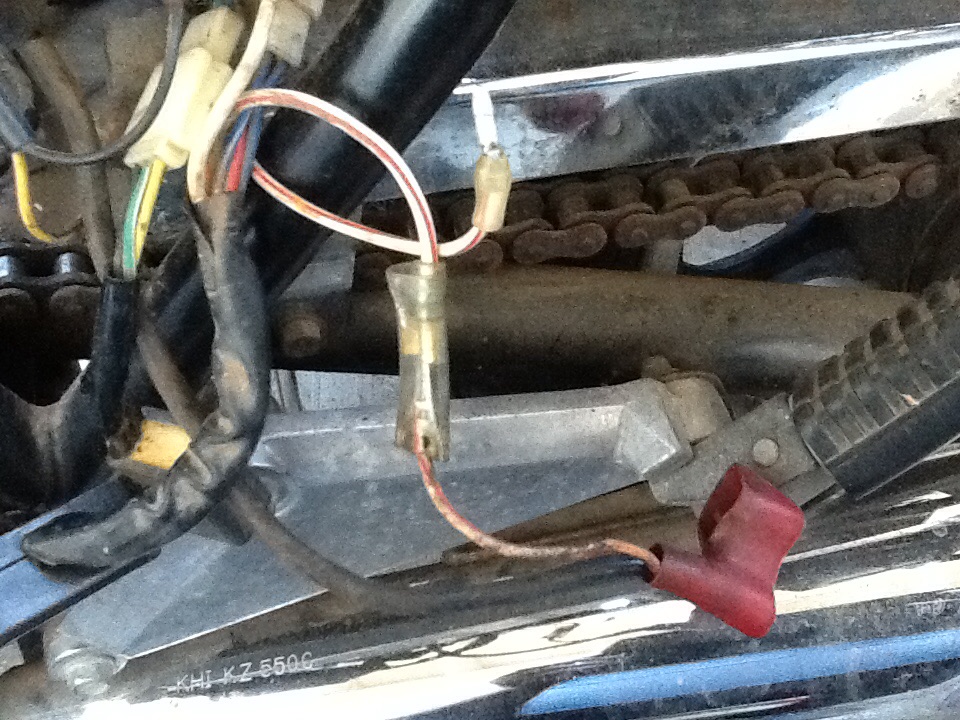

No manual. I pulled the fuse nothing changed. I pulled a wire that was connected to a but that was connected to the battery....and it works like it should. The carb is off so I really don't know what not working now but I'm happy I'm close to the problem or at least I think so

You need a manual. Loud has one in his signature. That's a reg/rectifier. It is important.
