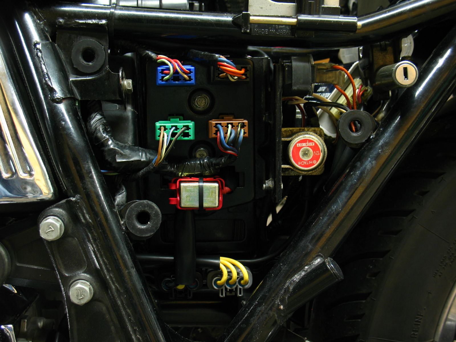

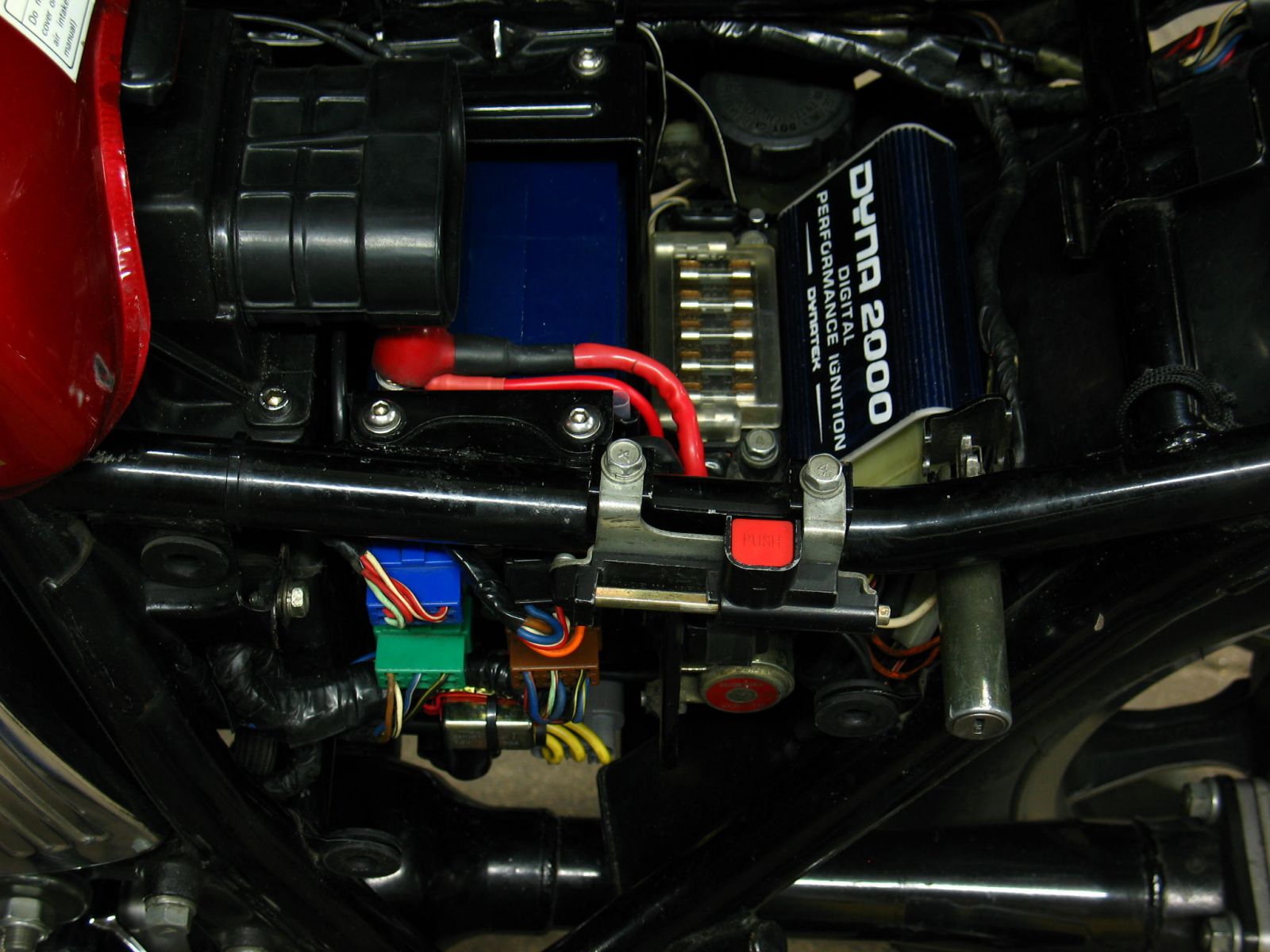

Current electrical setup on the KZ1100-A2.

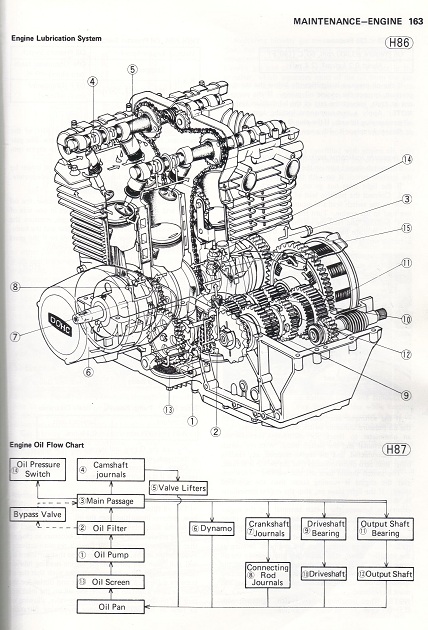

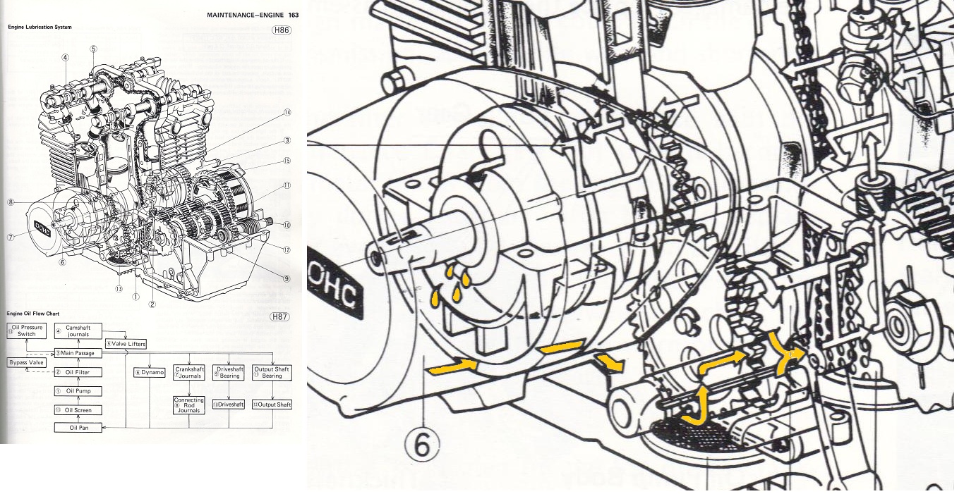

Trying to sort out charging system issues on my 750 and thought back on this post because the stator is dry on my bike. No way for the stator to heat the oil in this configuration. My GS1000 has the stator exposed to the engine oil. How is the big KZ engine set up? Dry stator or wet?
- Posts: 18564
- Thanks: 2103
Re: Regulator Rectifier
26 Oct 2015 05:25 - 26 Oct 2015 05:27Nessism wrote:daveo wrote: Do you think the engine would run cooler with the SH775, since the stator (and subsequently oil) won't get as hot?
Would suspect that the few drops of oil making their way into the large KZ's stator area (underneath the alternator cover) likely has negligible effect on oil temperature.
Last edit: 26 Oct 2015 05:27 by Patton.
- Posts: 23785
- Thanks: 3050
26 Oct 2015 05:54Nessism wrote:daveo wrote: Do you think the engine would run cooler with the SH775, since the stator (and subsequently oil) won't get as hot?
Wet. I've had no issues with it being that way though. :dry:
