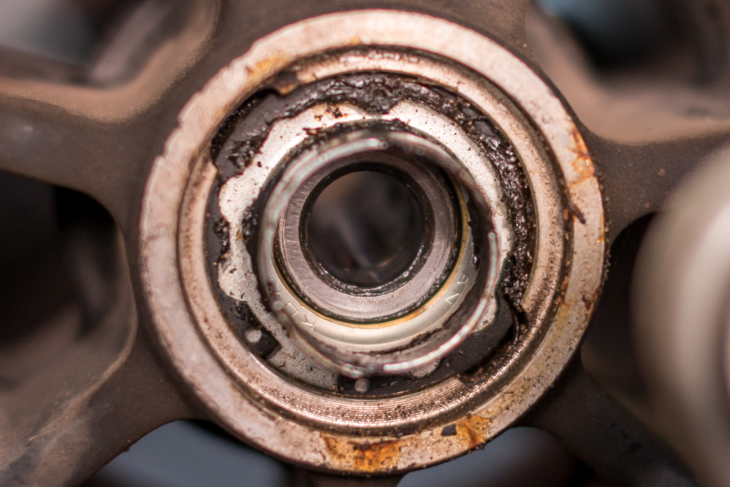

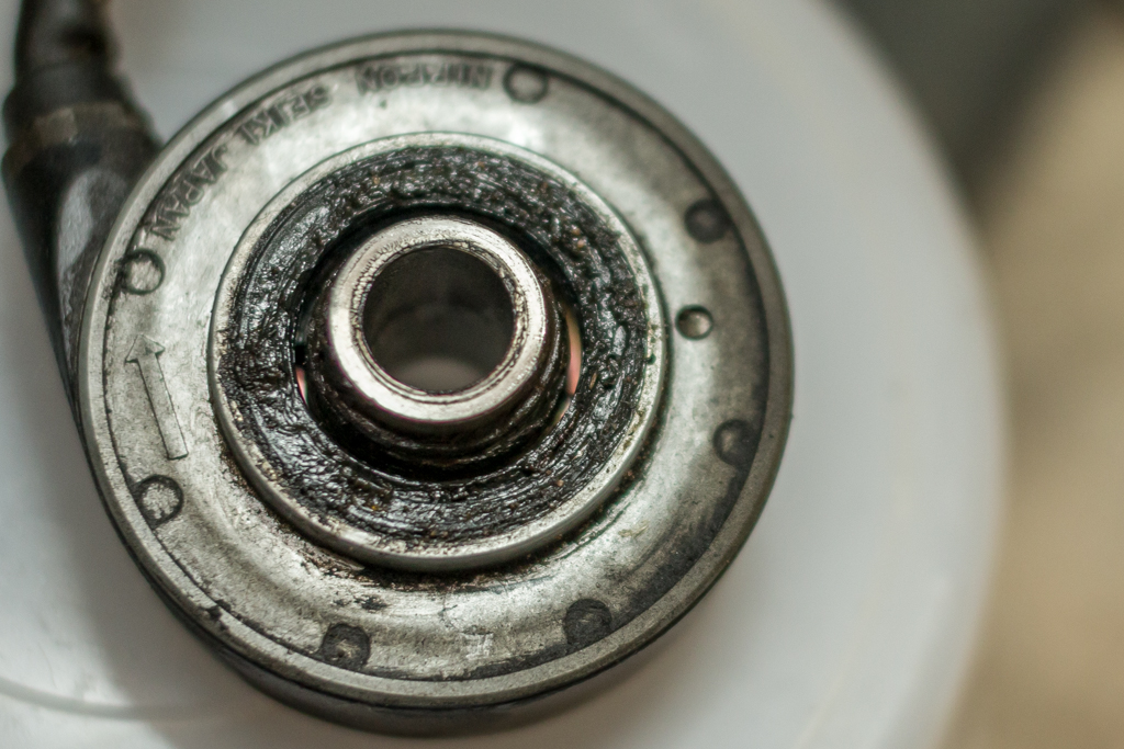

Okay so big update, finally had time to work on this problem, and I have no freakin' idea of what to do. There is some grease around the sensor, but I don't know if the grease is supposed to be inside the sensor or not. There is a black seal in the picture below that is covered in grease. Is this seal supposed to keep grease out of the sensor or is it supposed to keep grease inside the sensor? I'll remind you again, this is an electric sensor. See photos below for reference.
This is what the sensor looked like right after I took it off.
This is the mating surface of the sensor on the front wheel hub.

You need to clean out the old grease and repack it with new grease.

24 Jul 2015 22:06swest wrote: You need to clean out the old grease and repack it with new grease.
Regular synthetic bearing grease should work for that? All I have is some Mobil 1 bearing grease. Thanks Steve!! I'll have to get on this in the morning.

25 Jul 2015 10:30 - 25 Jul 2015 10:31swest wrote: What does your manual call for?
The manual was pretty useless, just covered how to take the sensor off and back on. Nothing on servicing the sensor at all, you're just supposed to replace it I guess. I cleaned out as much original grease I could and put back in some of that Mobil 1 bearing grease, didn't pack it in though.
So I put it back together, and the problem persists...perhaps a bit worse. It changed, it used to favor the top point of the bouncing and hold it there for a moment before dropping down to bounce back again. Now it's consistently bouncing in an about a 5mph range, roughtly 15% lower than what the actual speed is (that % really hasn't changed). So this sucks, I really don't wanna get ripped off on a $110 used sensor on eBay. At this point though I think I don't have a choice. A dealer would charge me more than $110 for fixing it right?
