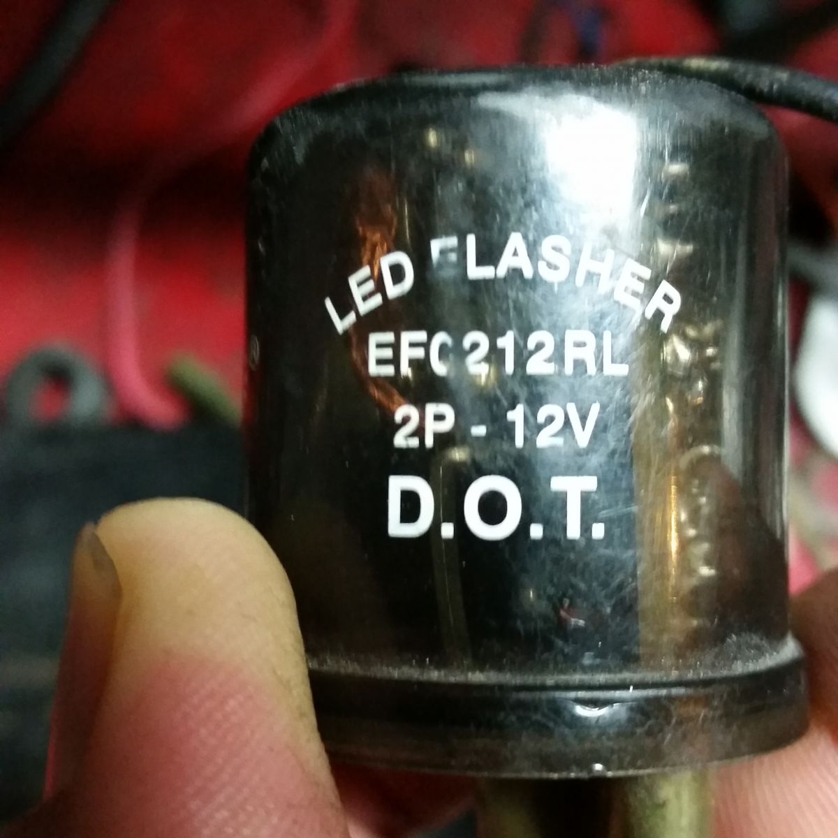

This is what I used Steve. Went in to O'Reilly Auto parts and asked for an LED flasher, worked great.

Thanks. I found that thread. I jotted down the numbers. I'll check it out tomorrow.

Went to OR and gave them the #'s No listing, then to AZ, nothing. These places are as useless as tits on a boar. I'm ordering it on line. Much cheaper too.

27 Jun 2015 18:06I tried find you the part online @ OR and did not find it either. I can send you the one in the pic if you want it. I don't need it with the M-unit.swest wrote: Went to OR and gave them the #'s No listing, then to AZ, nothing. These places are as useless as tits on a boar. I'm ordering it on line. Much cheaper too.

That would be great, what will you need for it. Thanks.

Nothing, I mean it this time! I will put it in a padded envelope and ship it. Just don't ask me how to wire it. It should just replace the stock one, only this one has a ground wire that comes out of the top.

SWEST, I installed LED lights on my sons new Ninja300. Once we completed the install and went to test the turn signals, the LED's stayed on, no flash at all. We went to Cycle Gear and bought this flasher module. Lights work great!

I think we have it nailed down. It's strange they would sell LED's but have no clue that they require new flashers. :dry: OR has some that say LED compatible on the back. That would require adding a new circuit and a crap shoot.
