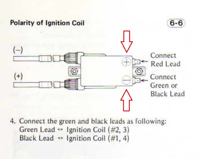

02 Mar 2015 14:58martin_csr wrote: The stock ignition coils from my 81 650-CSR are embossed w (+) & (-) and the manual makes reference to the polarity.
Here's an example from a KZ650 FSM:
why the primary terminals are labeled with polarity;
why the secondary circuit high tension spark plug wires are labeled with polarity;
the difference between these polarity labeled ignition coils and the more common non-polar ignition coils.
Ignition coil polarity isn't shown on the wiring diagram.
