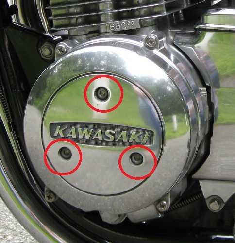

Are you absolutely positive the engine is a 1978? Take a look at the images below. If your generator cover looks like the one with the 3 red circles it is a 1977. If that is the case, it will not run without a battery. The 2nd image is that of a 1978 generator cover. Ed
Attachment 1978GeneratorCover.jpg not found
