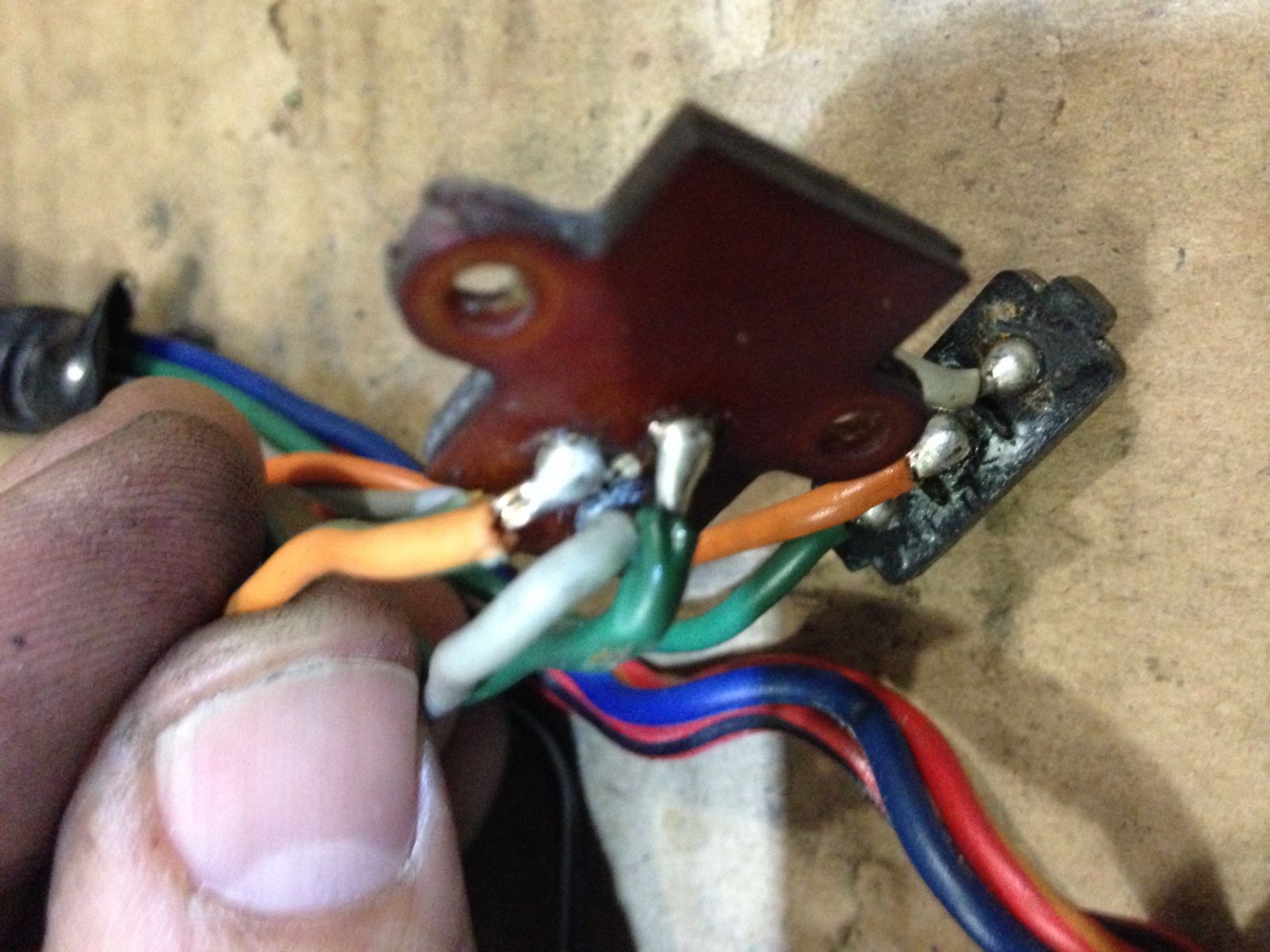

since im waiting on the valve cover gasket to arrive....the left side controls had issues with the blinker working all the time.
so i open the controls and found 3 solder apart from thecontact block.
went on to the repair

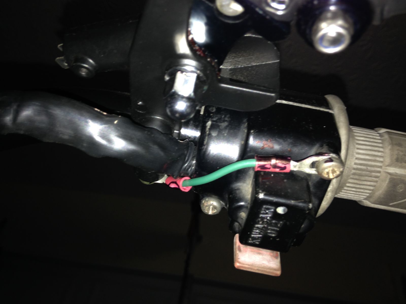

also had a problem with the horn not working.....found the control block not getting ground from the handle bars because of the paint.
there was ground present on the clutch bracket ( ground travel through the clucth cable ) install a piece of wire from with open end connector from clucth bracket screw to left control screw.
wire been paint black....cant really tell, see it
