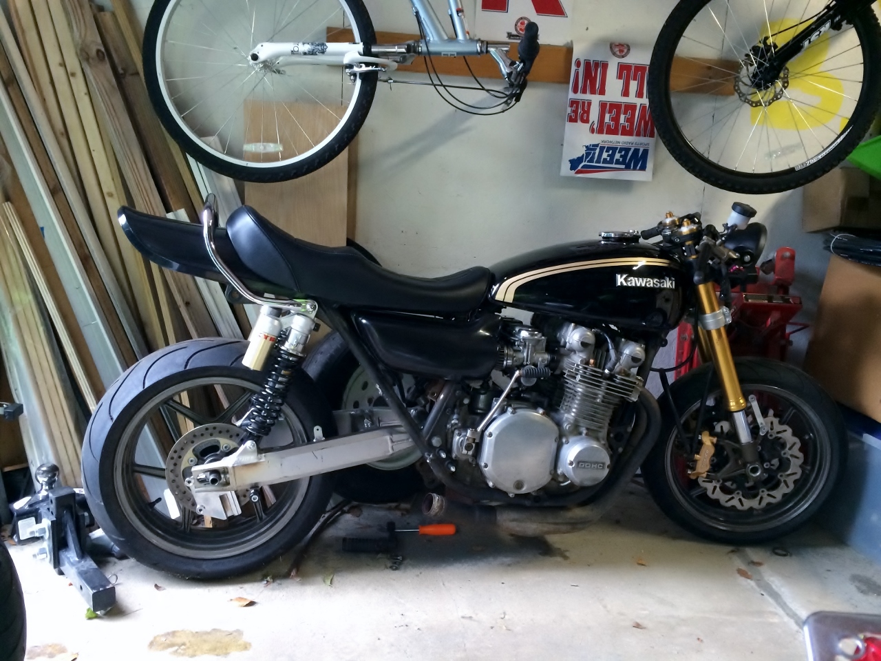

I know pictures help so here is like the only one I have from when i first got it out of the field but with a new seat and grab bar stuck on. The other one shows the direction I am going and some progress made.
