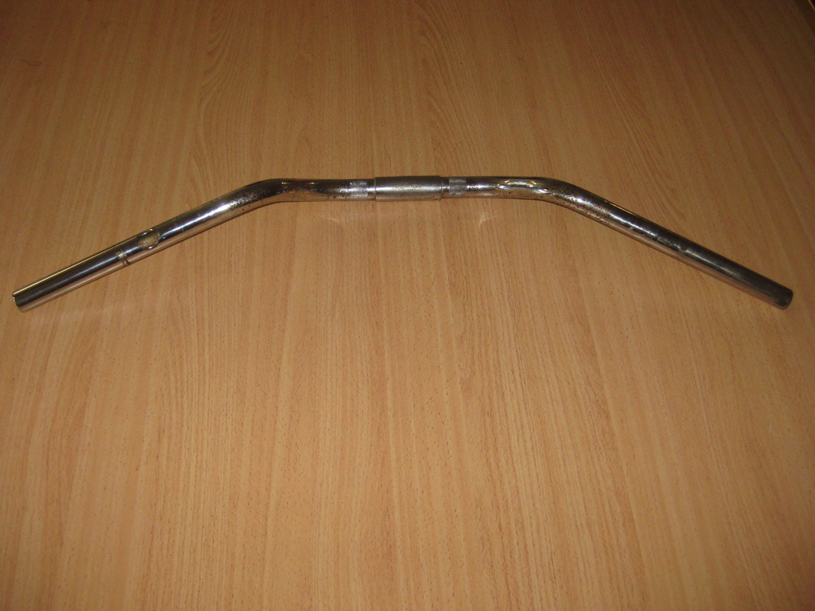

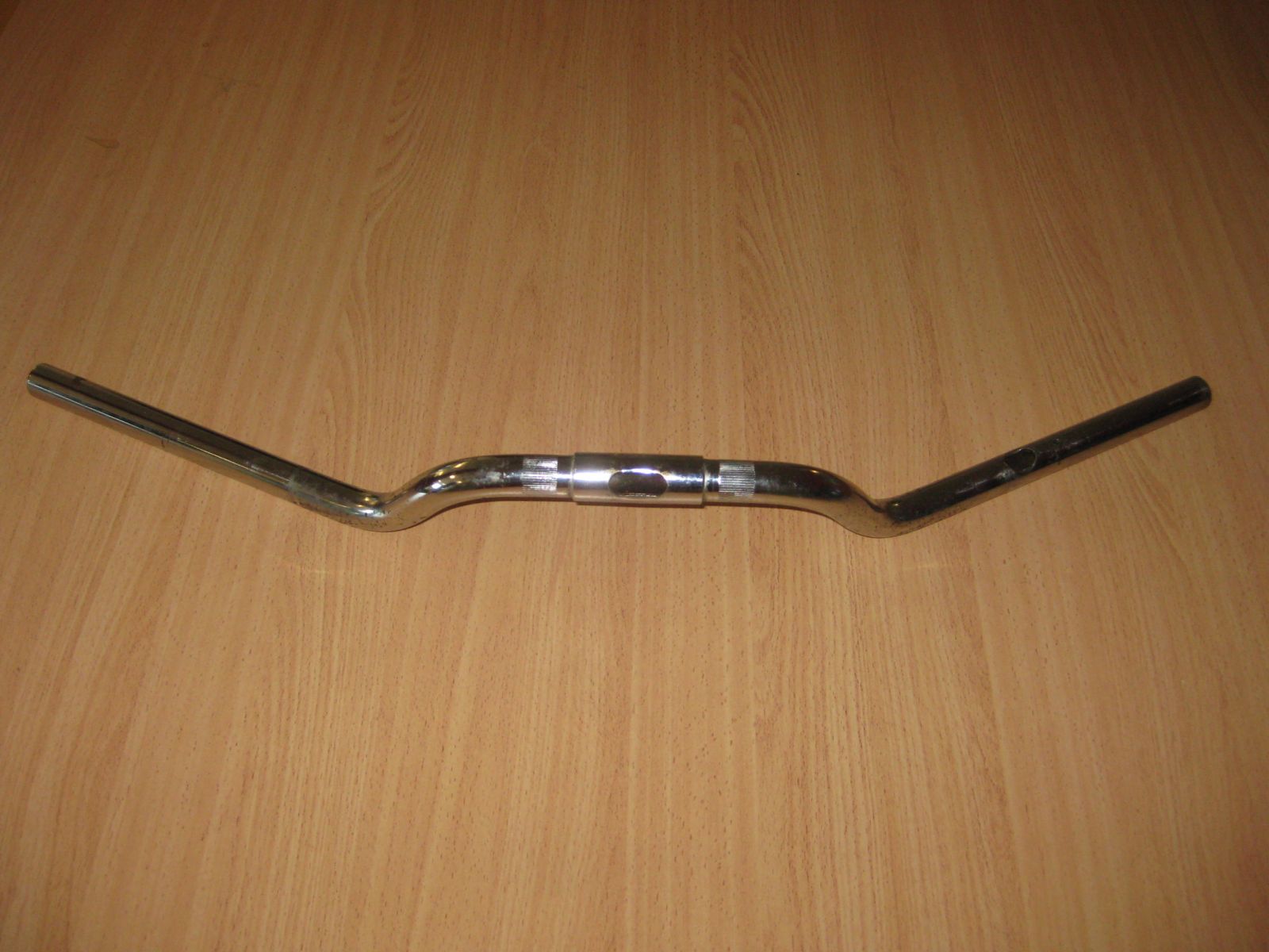

09 Sep 2014 04:48 - 09 Sep 2014 04:49Not sure what you're trying to hide, but a good start would be to use some handlebars with some notches cut out to allow the wiring from your LH and RH switch blocks to be tucked away out of sight - Z1-R used bars like this to tidy up the wiring. Need to make sure you minimise the cutouts so as not to weaken the bars tho'. You'll need to also round off the cutouts so they don't chafe/cut through the wiring. Probably require a trip to the platers after the engineering to restore the bars to their previous glory.NB Z1-R bars with cutouts are not NLA - I was lucky enough for mine to be able to be straightened and re-chromed and they look pretty good. Attached are a couple of pics of my bars before straightening and chroming
to show location/size of the original cutouts.

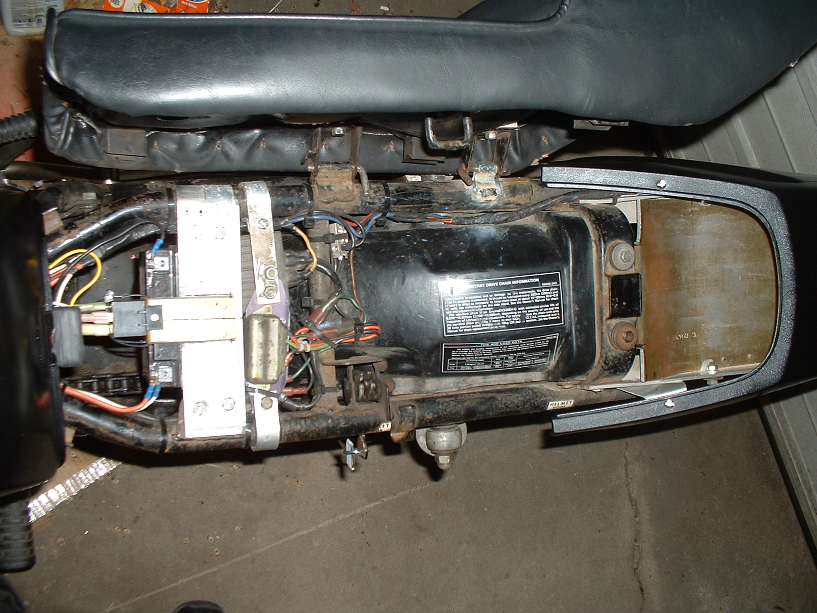

Depends on how much stuff you are keeping. You can hide all of the essentials between the frame rails under the seat (where it will stay relatively cool). The frame rails hide them well. I usually hide lighting related stuff under the tank.
The battery is obviously the most difficult thing to hide.
If you will be using electric start, then you have to keep it full size, or you could try one of the new LiFe Po batteries. There's up and down to those.

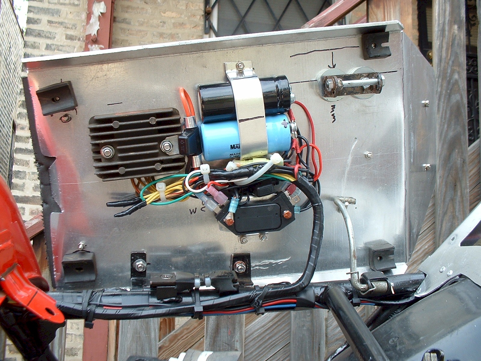

On this KZ550, I eliminated the battery. That's a capacitor in it's place (along with a spare).
There is also the reg/rec and igniter module.

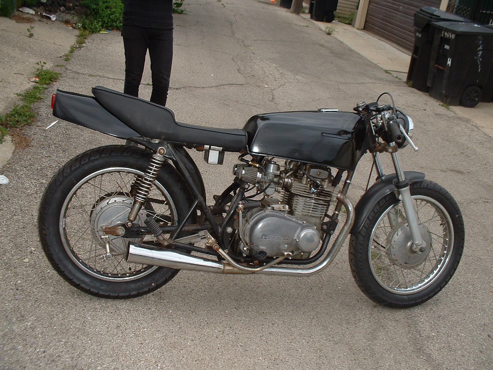

This KZ650 uses a similar setup, but with a scooter battery. You can see about half of the battery hanging down.
This KZ400 uses the same setup, and before we painted the battery hanger, you could see it well.
