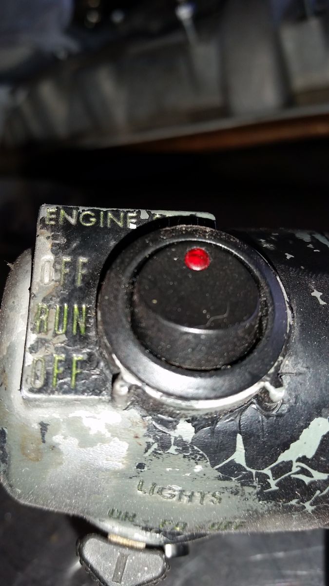

I have a solution for you but it wont look stock. I used a switch that I got at Radio shack. Works great and has been in all kinds of weather. I did have to modify the hand control to accept it. The whole was the right size but I had to drill out below it to to clearance for the connectors. I don't have a stock bike so it doesn't matter to me.
