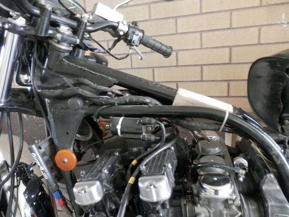

So I took off the wiring harness on my bike to redo it with soldering connections instead of the broken connectors. Problem is I don't remember how it was originally routed. If someone could please show me how that would be great. Thanks!

I just pulled the tank and took a a quick pic. Should be pretty much the same as your even though mine is a Canadian model. The connector from the right handlebar enters the harness the other side of the frame.
Hope it helps
