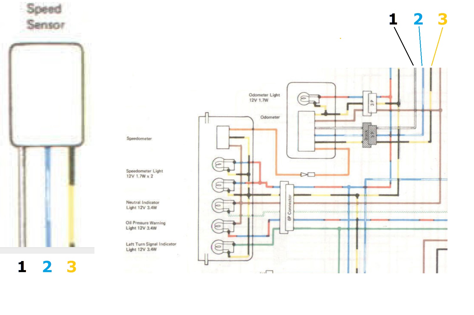

Here's a link to download the J model wiring diagram from the FILEBASE:
www.kzrider.com/filebase/search/finish/1-general/238-z1000j1
Note the speed sensor wiring:
The following user(s) said Thank You: jtpvg

But when I go to order a new one for the bike it says is it cable driven. Thats what I don't understand. Any bike I've ever had was cable driven so I'm new to this whole electric drive thing. Would any electric driven gauge work then. They are expensive so I really dont want to take a chance and it not work.
