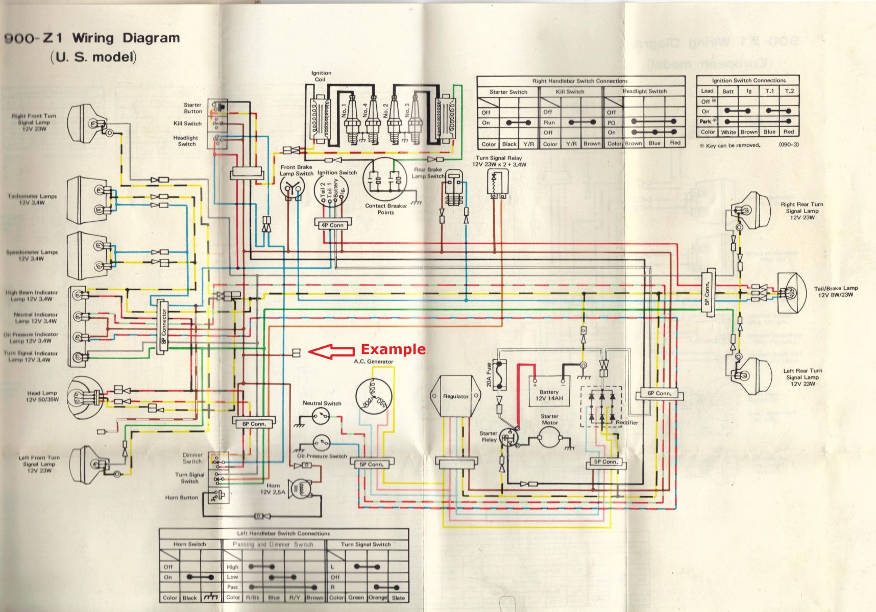

The wiring harness on many models may include an extra terminal which may be used to power an accessory.
Such extra terminal may show on the wiring diagram, probably at the end of a brown color wire.
Physical location could be an unused female bullet connector on a brown wire from the harness underneath a side cover, seat, tank, or inside the headlight shell.
KZrider's FILEBASE contains many wiring diagrams for various KZ models.
Good Fortune! :)
