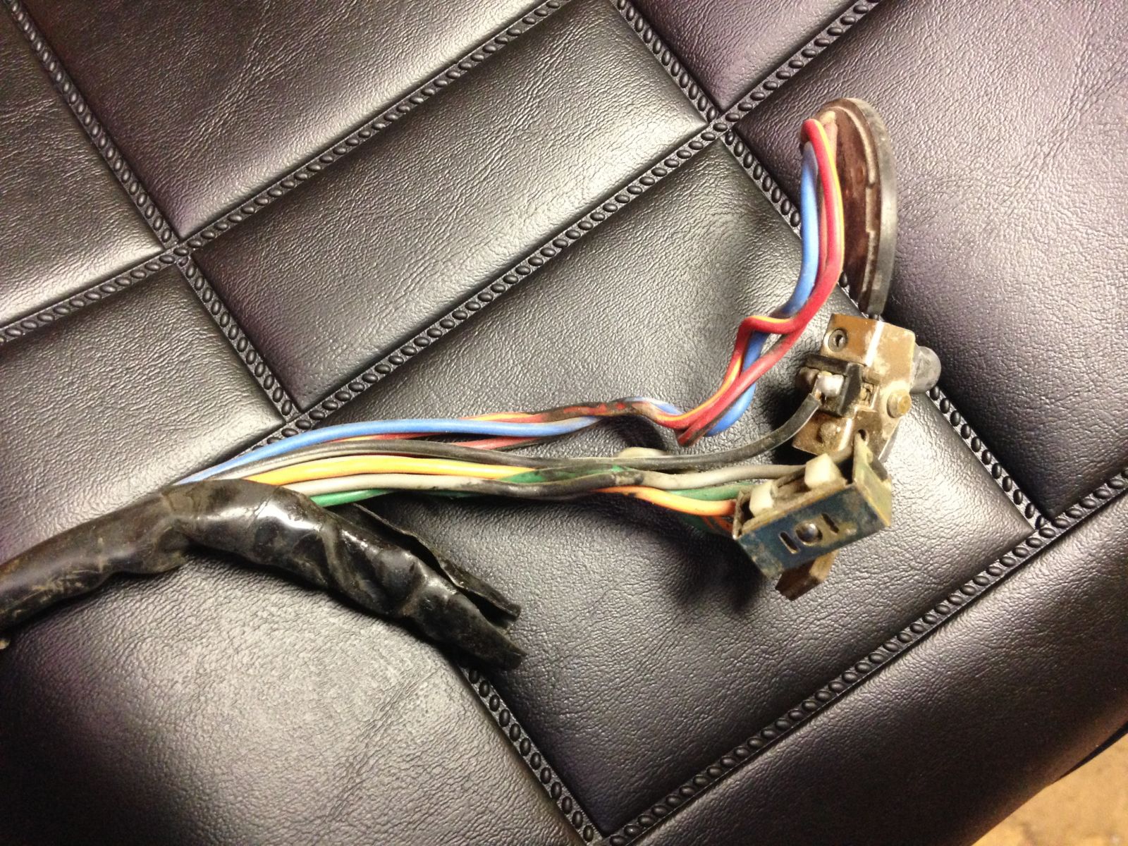

Need to replace the plactic sleeve on both of the hand controls wiring......anyone know were i can buy the sleeve only

When you repair your loom and you need to tape wires where they branch out of the loom sheathing or where the sheathing ends (or if you wrap the whole loom rather than use sheathing) I would highly recommend using F4 Self-fusing Silicone Tape to wrap the wires. This stuff is great. It looks much like electrical tape, but that's where the resemblance ends. When you use it you stretch it as you wrap things (wires, sink drains, you name it). Stretching it activates some magic molecules in it and makes it bond to itself. Of course, it insulates electrical connections, but what's so great about it is that it doesn't have any gummy adhesive and it doesn't stick or bond to the wires themselves. It only sticks to itself. So if you ever need to remove it there is no sticky residue, plus heat doesn't make any gooey stuff seep out like electrical tape. A 36' roll goes a long way because you stretch it to use it. Here are a couple links about it. Ed

www.easternbeaver.com
might be able to get you the sleeving.

I got some sleeving from McMaster Carr. They have several sizes. It looks just like OEM when installed.
