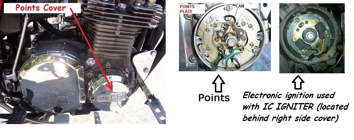

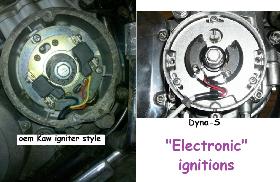

including the igniter and stock points -- Nope, can't have both.
If the bike at hand has stock points ignition, it does NOT have an igniter.
If the bike at hand has stock electronic ignition, it also has an igniter (located behind the right-hand side cover -- "IC IGNITER").
According to kawasaki.com, either ignition system may be found as the stock component on a 1979 KZ1000-B3 LTD. That is to say either "points" or "electronic ignition."
Each system requires a different coil.
Points require 3.2~4.2Ω resistance coil.
Electronic ignition requires 1.2~1.9Ω resistance coil.
Points system will damage a 1.2~1.9Ω resistance coil.
Electronic ignition has a weaker than normal spark with 3.2~4.2Ω resistance coil.
May simply remove the "points cover" in order to see and confirm which type of ignition is fitted.
If different than either of the above, it might be a Dyna-S aftermarket electronic system (that replaces points and doesn't use the Igniter) and is supposed to use 3Ω coils.
