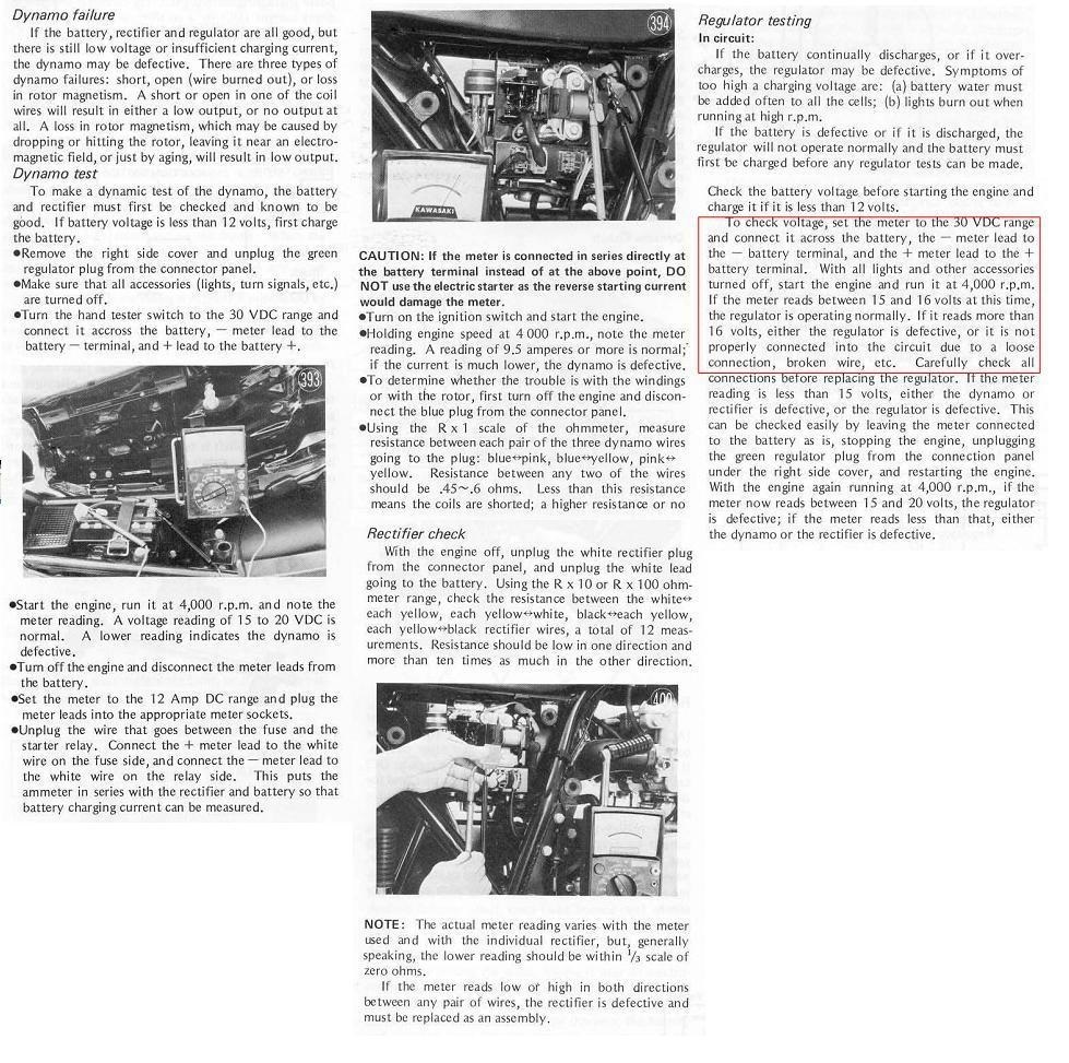

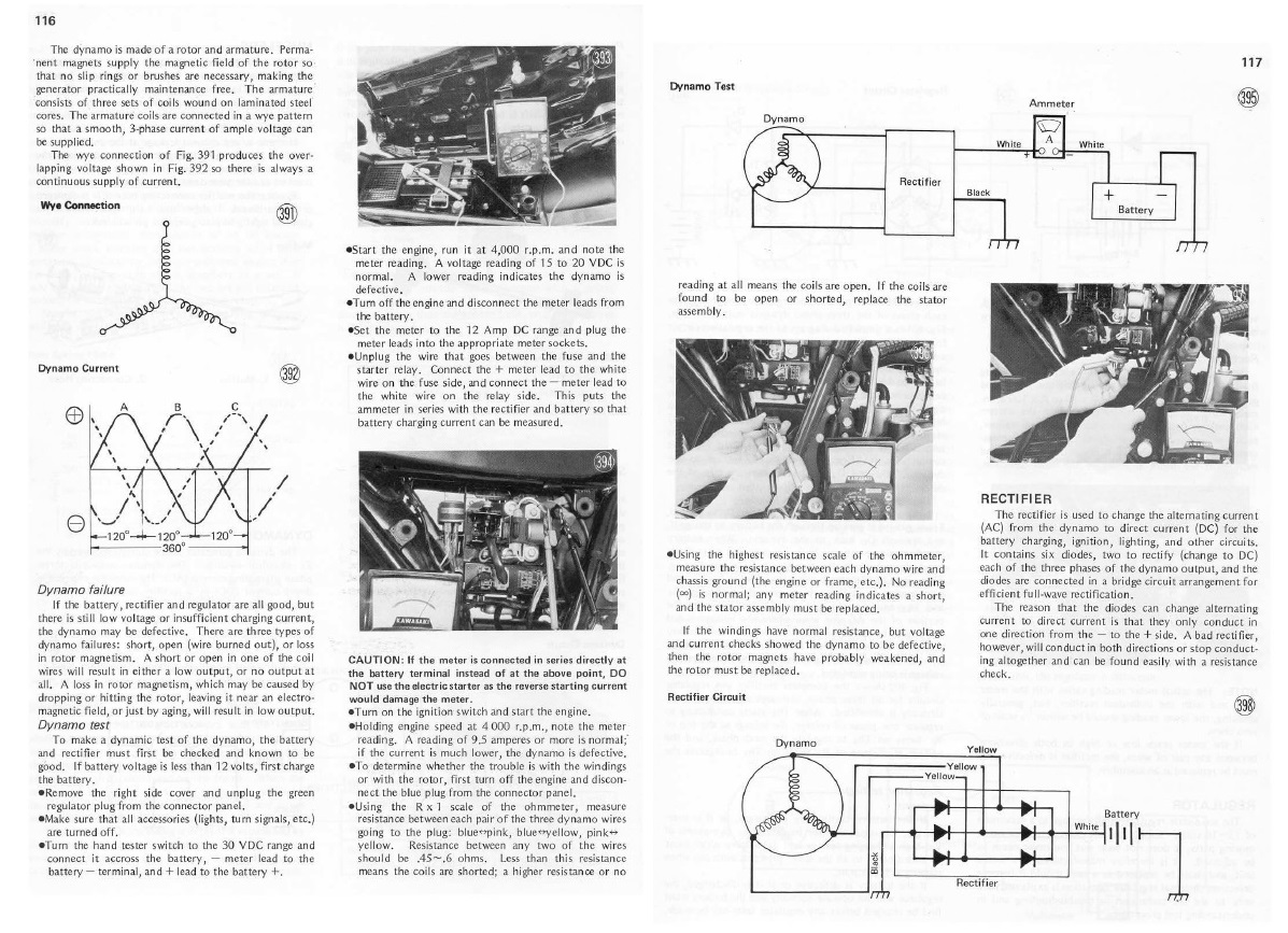

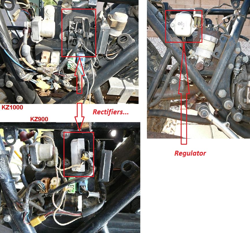

hope this helps to get you going.... Good luck!
This was written for the KZ900 where '79 should be~ the same in T-shooting anyways.

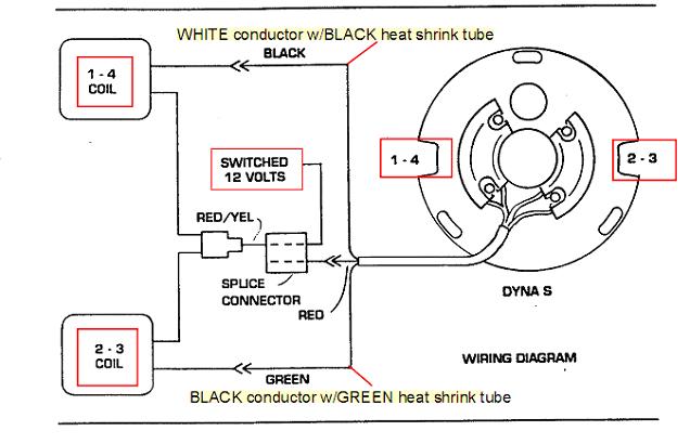

Unknown if you have points or EI ignition setup so adding just in case....
Attachment KZ900ElectricalTests.jpg not found
Attachment IgnitionCoilTesting.jpg not found
Attachment KZ900RectifierTegulatorSchematic.jpg not found
Attachment ElectricalTroubleShootingOEMGuide.jpg not found
