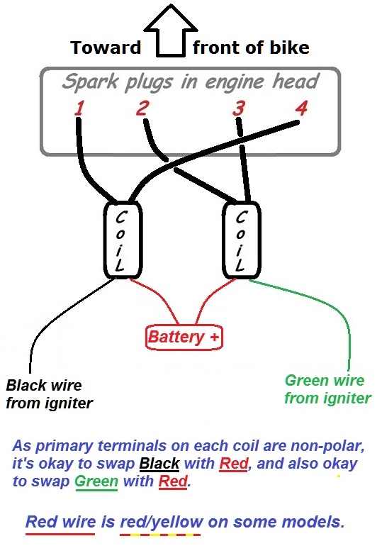

Hi, I just bought 3 ohm green dyna coil for kz 1000j 81,
I just wondering if my bike has ballast resistor? and how can I connect this dyna coil.

aviliora wrote: Hi, I just bought 3 ohm green dyna coil for kz 1000j 81,
tnx
Here's the wiring diagram from KZr FILEBASE.
www.kzrider.com/filebase/search/finish/1-general/238-z1000j1
The ignition coil circuit doesn't show a resistor.
Connections are the same as with stock coils.
Port-side coil (with black primary wire) attaches to outside spark plugs #1 and #4.
Starboard-side coil (with green primary wire) attaches to inside spark plugs #2 and #3.
Good Fortune! :)

#629641
Hi, am looking into replacing the coils and wires on my 1980 kz1000 LTD B4, this bike has the stock electronic ignition and does have a ballast resistor in the wiring for the coils. It is located forward of the coils attached to the frame, it can be seen easily, it looks like a block of white ceramic about 1/2" square and 2" inches long. Going to 3 ohm plus coils it is recommended to just join the two wires connected to it (red and pink) together and remove it.
