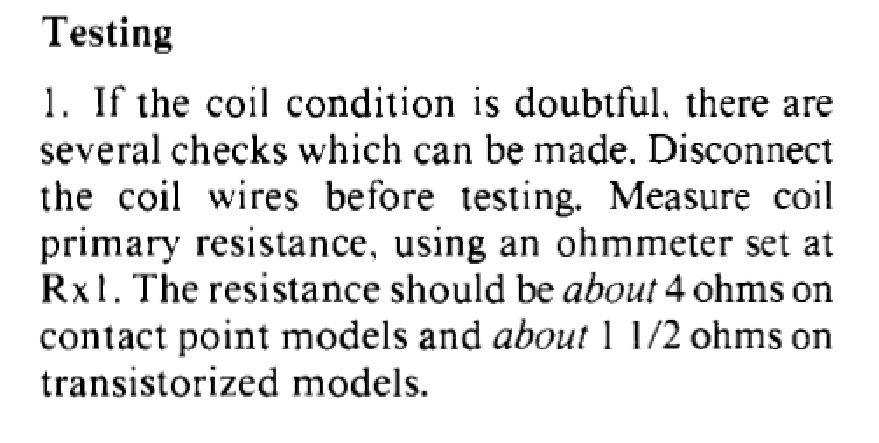

If needed, a service manual may be downloaded, courtesy of KZr Member loudhvx.
General
home.comcast.net/~loudgpz/GPZweb/index.html#home
Service manuals
home.comcast.net/~loudgpz/GPZweb/Mnls/Mnls.html
The manual at hand shows:
General
Service manuals
