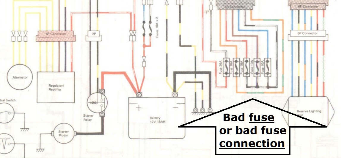

Pacemaker wrote: ... I don't lose everything, i still have lights, instrumentation cluster... looks like im just going to cut the harness open and visually check all wires and run through them with my multimeter
Before cutting into the harness, would check for battery voltage at both ends of each fuse, and also assure the integrity of both connections at the ends of each fuse.
Good Fortune! :)

SOOOOOOOO.....I've heard the word headlight used several times, and i decided to pop it open and see what all the fuss was about, now excuse my language but it is a bit of a cluster f*ck in there, i was a male and female connector that was partially attached and i made sure it was jammed in there completely and the bike fired up, but when i pulled it back to where it was barely connected thee bike wouldn't run, but i can't seem to recreate the issue i was having where the rpm guage would bump when i hit start, this time it acts like the clutch isn't in at all and the lockout is kicking in, but with those wires connected it fires right back up, so i guess my issue is in my headlight or in the tangled mess of wires that it holds, reckon i'll just have to dive in and wiggle every connection untill i can recreate the issue

The headlight shell is an excellent place to go in and start cleaning connectors (I use Deoxit) and making sure they are fully conneted.
