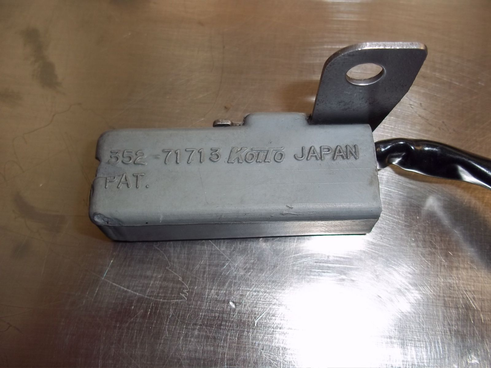

Here's a link with some more details:
www.kzrider.com/forum/4-electrical/53943...-what-is-this#539457

Just got it fixed. It was the part in Patton's link. The connection came slightly apart and needed to be pushed back together. Thanks for the help everyone
