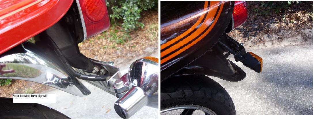

Check out what Patton did with his 900 ltd signal's.. if you run with bags theyr out of the way

Can fab simple bracket located underneath license tag to attach stock or aftermarket blinkers.
Keeps blinkers from interfering with fitment of soft throw-over saddle bags.

Looks pretty good to me, definitely an option to consider, especially with the smaller signals. Nice bikes Patton, I checked out the links in your signature!
