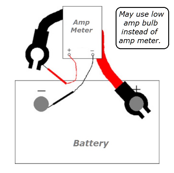

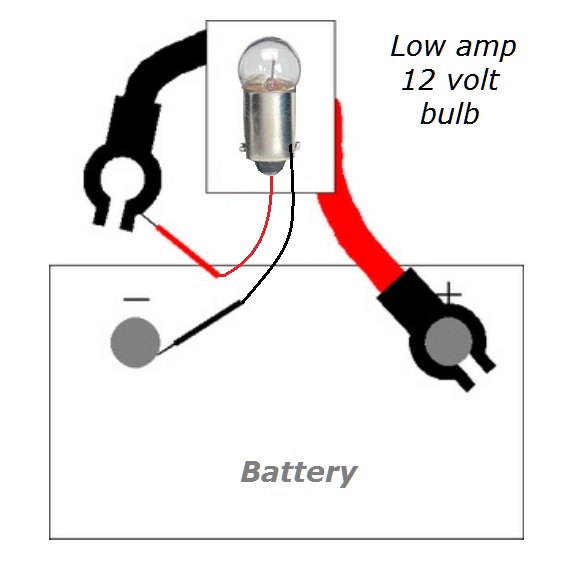

The battery itself may be failing to hold a charge, or there may be a current drain while the ignition switch is turned OFF.
To determine whether the issue is the battery or current drain, may just remove one of the battery cables to a fully charged battery, and if the battery dies in a day or so, it's likely due to self-discharge.
Where a good fully charged battery is dying while the ignition switch is OFF -- may use an amp meter, or low amp bulb (such as ½ amp).
Remove the negative battery cable, then connect the meter or bulb between the battery post and the negative cable terminal.
There should be no current flow with the ignition switch off.
