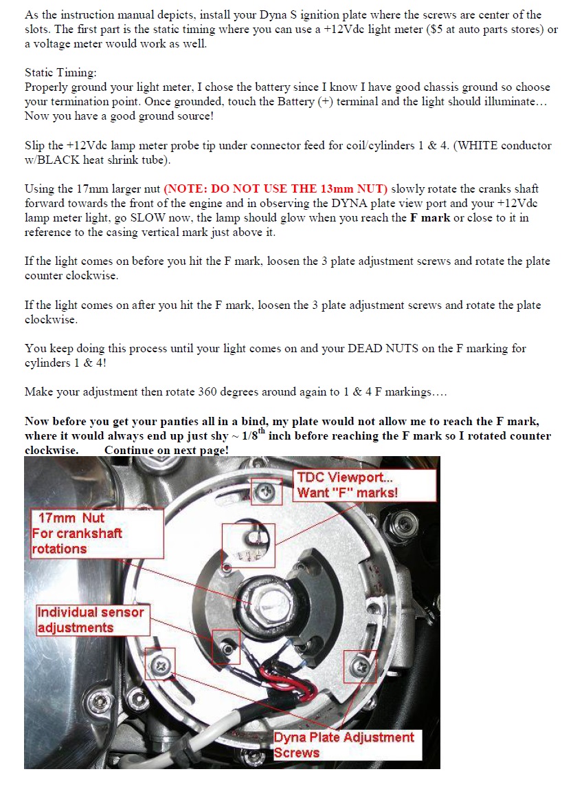

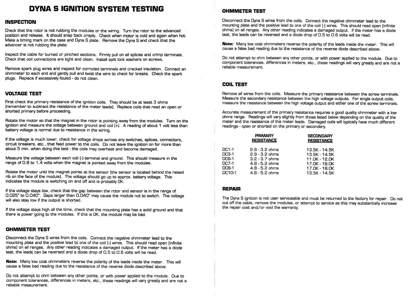

Red is the +12Vdc to the Dyna pickups....
Black conductor is the pickup feed to the coil for 2 & 3 cylinders.
Follow the link for installation, covers static testing as well....
Dyna S Static & Dynamic Testing
