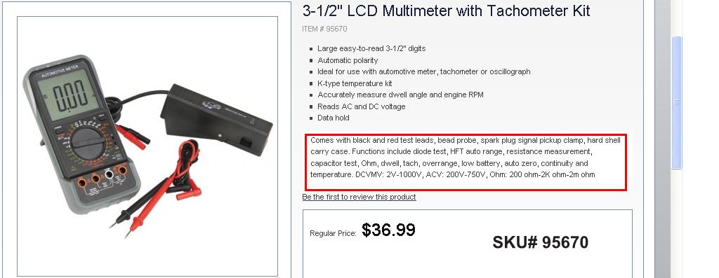

Do yourself a huge favor... Get a Volt meter instead....
Test light will illuminate under 12Vdc so miss reading voltage drops across a switch, connector, battery charge etc....
Home Depot, Lowes, Ace hardware, hell even Radio Shack has decent ones for ~ $20-$30 plus a DVM has resistance, and current measuring capabilities. Any of these would be better than just a test light especially for troubleshooting....
