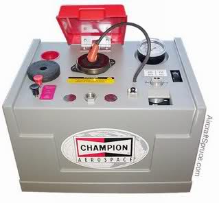

Cleaning 2 stroke plugs as in the Lawn Boy recalls the good old motor scooter days, refilling with Amoco white gas at service stations providing these:
Betcha OMR's also old enough to remember. :lol:

We had one of these at the garage where I worked during high school.
