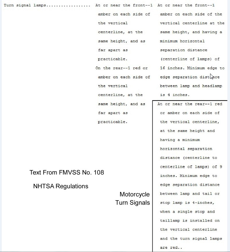

Those lights are not legal by DOT (federal) standards. Each state has it's own laws about what they enforce. In California, you would get written up for those.
To see why they fail DOt standards, read attached. It requires 9" separation from center of tail light lens to center of turn signal lense. That's why MC turn signals are mounted on stalks to get distance. At night, those turn signals just blur into the light from the center tail light.
