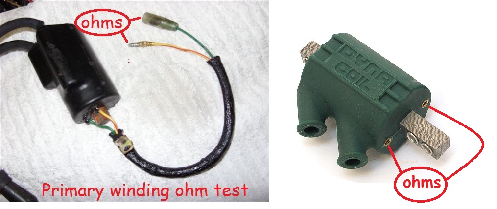

So how do I find out if stock coils are 3 ohms??? I have a harbor freight multi-meter that should measure resistance.

Measure resistance between the primary terminals.

uglee wrote: So how do I find out if stock coils are 3 ohms??? I have a harbor freight multi-meter that should measure resistance.
You will get a lot of measurement error at 3 Ohms. Measure the leads alone and subtract that from the coil reading.

For the most part, points ignitions use 5 Ohm coils, electronic ignitions use 3 Ohm coils.
You can use 5 Ohm coils with the Dyna S, but the spark will not be as hot.

koolaid_kid wrote: For the most part, points ignitions use 5 Ohm coils, electronic ignitions use 3 Ohm coils.
It depends on the dwell and coil's inductance, not just current.
Higher resistance coils usually also have higher inductance. With higher inductance, under certain conditions, the coils can store more energy than lower-resistance/inductance coils.
Higher inductance means the coils are "slower", meaning slower to charge. If you give them enough time to charge, they may end up storing more total energy than the "faster" coils.
Since the Dyna S gives a really long dwell, the slower coils will likely have more spark energy at idle, and the difference at higher RPMs may be negligible.
