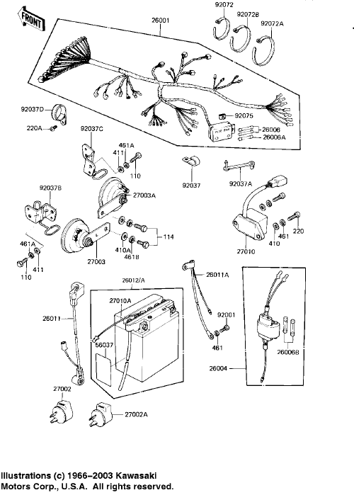

No eBay APP ID and/or Cert ID defined in Kunena configurationPer kawasaki.com
27003-1057 horn lh
27003-1056 horn rh
If the horns at hand sound off satisfactorily, and the horns are severable from the bracket by removing the nuts, could consider fabbing simple hang arms, for mounting per factory method.
I don't know what the assembly came from.
27003-1057 horn lh
27003-1056 horn rh

27003-1057 LH used on 19 models:
EX305-B1 (GPz 305) (1983)
KZ550-F1 (Spectre) (1983)
KZ550-F2 (LTD Shaft) (1984)
KZ550-H1 (GPz) (1982)
KZ550-H2 (GPz) (1983)
KZ550-M1 (LTD Shaft) (1983)
KZ700-A1 (1984)
KZ750-L3 (1983)
KZ750-R1 (GPz) (1982)
ZX1100-A1 (GPz) (1983)
ZX1100-A2 (GPz) (1984)
ZX550-A1 (GPz) (1984)
ZX550-A2 (GPz) (1985)
ZX550-A3 (GPz) (1986)
ZX750-A1 (GPz 750) (1983)
ZX750-A2 (GPz 750) (1984)
ZX750-A3 (GPz 750) (1985)
ZX750-E1 (GPz 750 Turbo) (1984)
ZX750-E2 (GPz 750 Turbo) (1985)
27003-1058 RH used on 18 models:

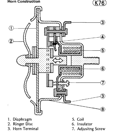

Per FSM page 247, each horn has an adjusting screw whereby it may be tuuned for the best (i.e., loudest) tone.
