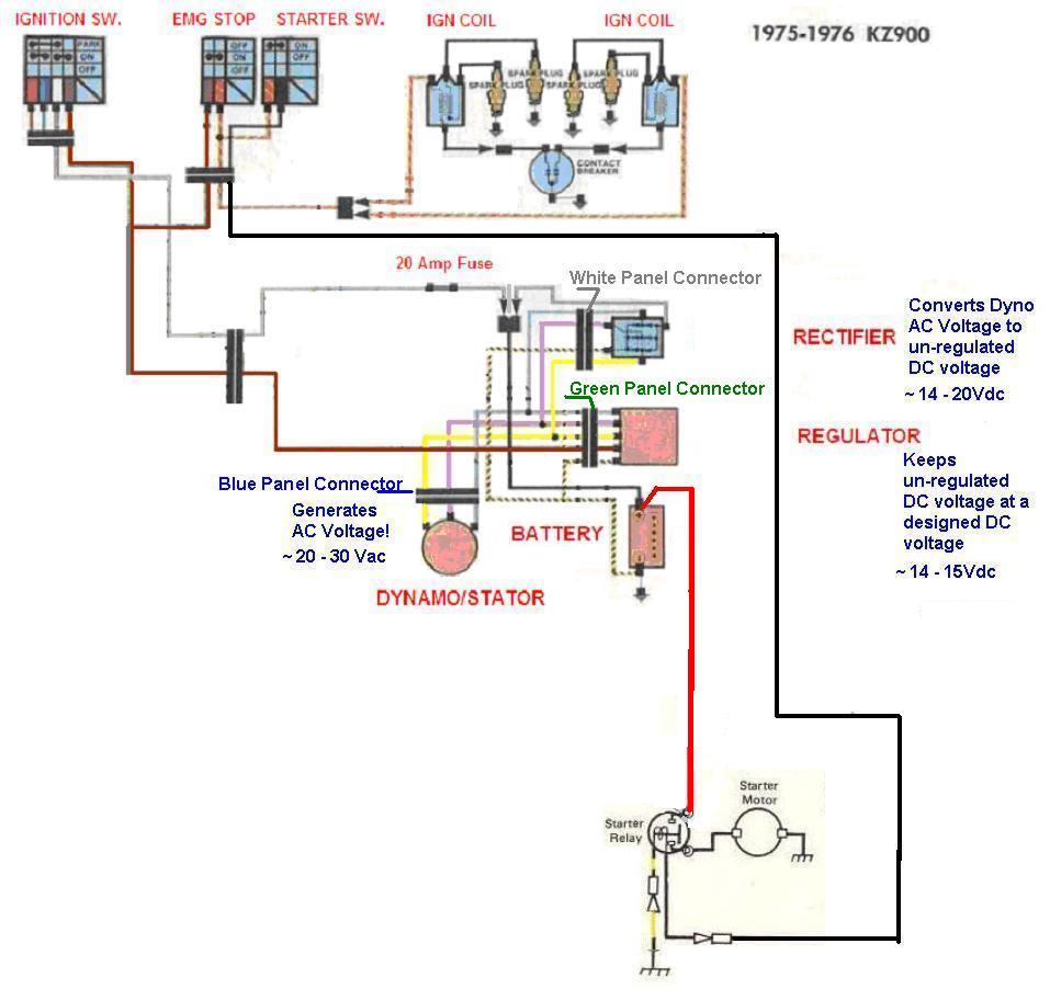

Follow the link for the Z1 service manual, 98% the same.....
Z1 Service Manual....
'76 KZ900 electric testing....
