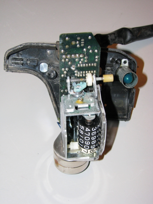

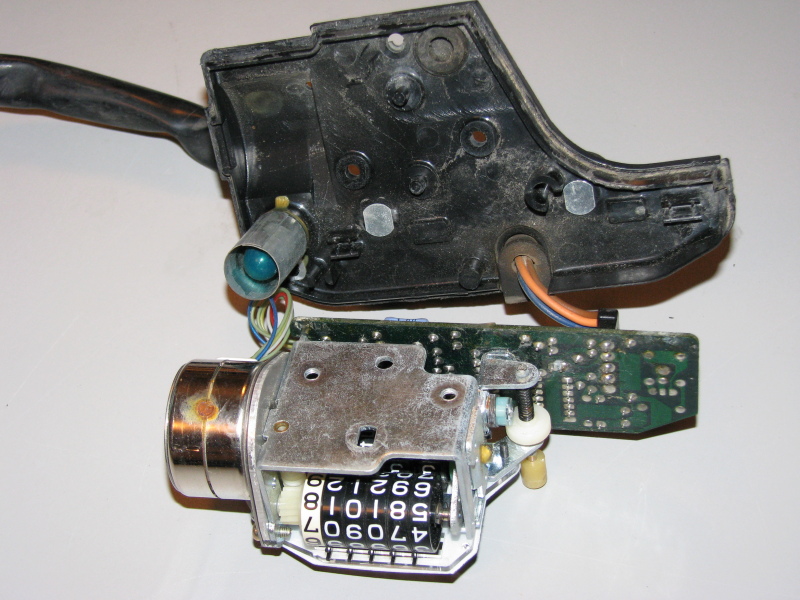

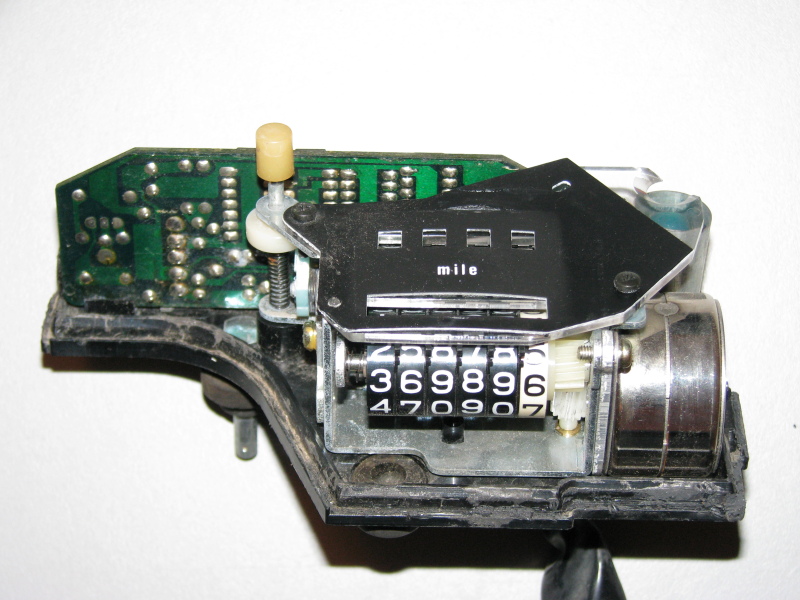

As promised, photos of the odometer internals. Nothing much needed to pry the case open -- it felt like a thin layer of black silicon being pulled apart... A little time and a small flat-blade screwdriver were all I needed. Note that this is from the standard model, and does not contain the sensor that turns off the turn signals.
The case laid open
The shiny cylinder on the right side is the stepper motor that advances the odometer
Removing the small screw in the center will free the plate on the left side of the dials. It looks like they will just fall right out.
The two screws visible on the back of the case actually hold the odometer to the back panel. They do not need to be removed in order to pry the case apart.
The case laid open
