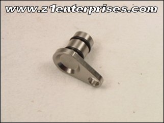

Another option:
Click here > www.z1enterprises.com/ItemDetails.aspx?i...Z1000&item=PM81-2290
