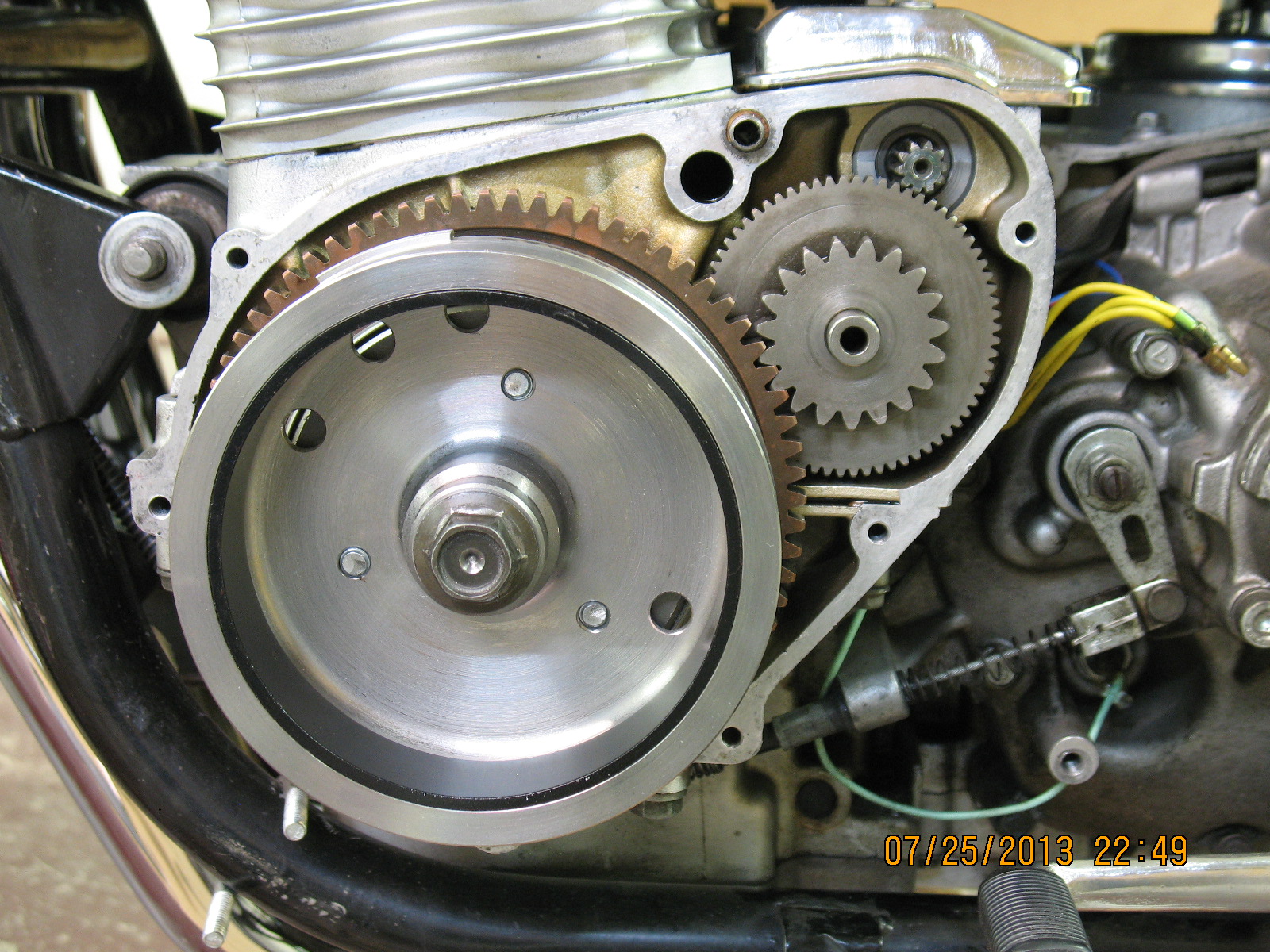

Update: One new Electrex RO3 rotor shipped 7/23 from England. I purchased another, rather than wait.
I anticipate a quick turn-around (refund) once Electrex has examined the defective magnet.

Re: Charging problem cause?
26 Jul 2013 15:59 - 08 Aug 2013 10:25
1982 KZ1100-A2/1170 sleeper 😀
Last edit: 08 Aug 2013 10:25 by daveo.

How way different? Better throttle response? Keeps the battery fully charged at lower rpm's(Electrosports stators are supposed to be overwound in this regard). Any e-mail from the maker of the defective rotor yet?

26 Jul 2013 19:03 - 08 Aug 2013 10:29
MFolks
This is the new version of the RO3 rotor. I'm noticing much smoother engine operation, along with better throttle response.
26 Jul 2013 19:48
Probably a heavier rotor, and better balancing have a lot to do with engine smoothness. Might be an engineering change, requested by customers too.
