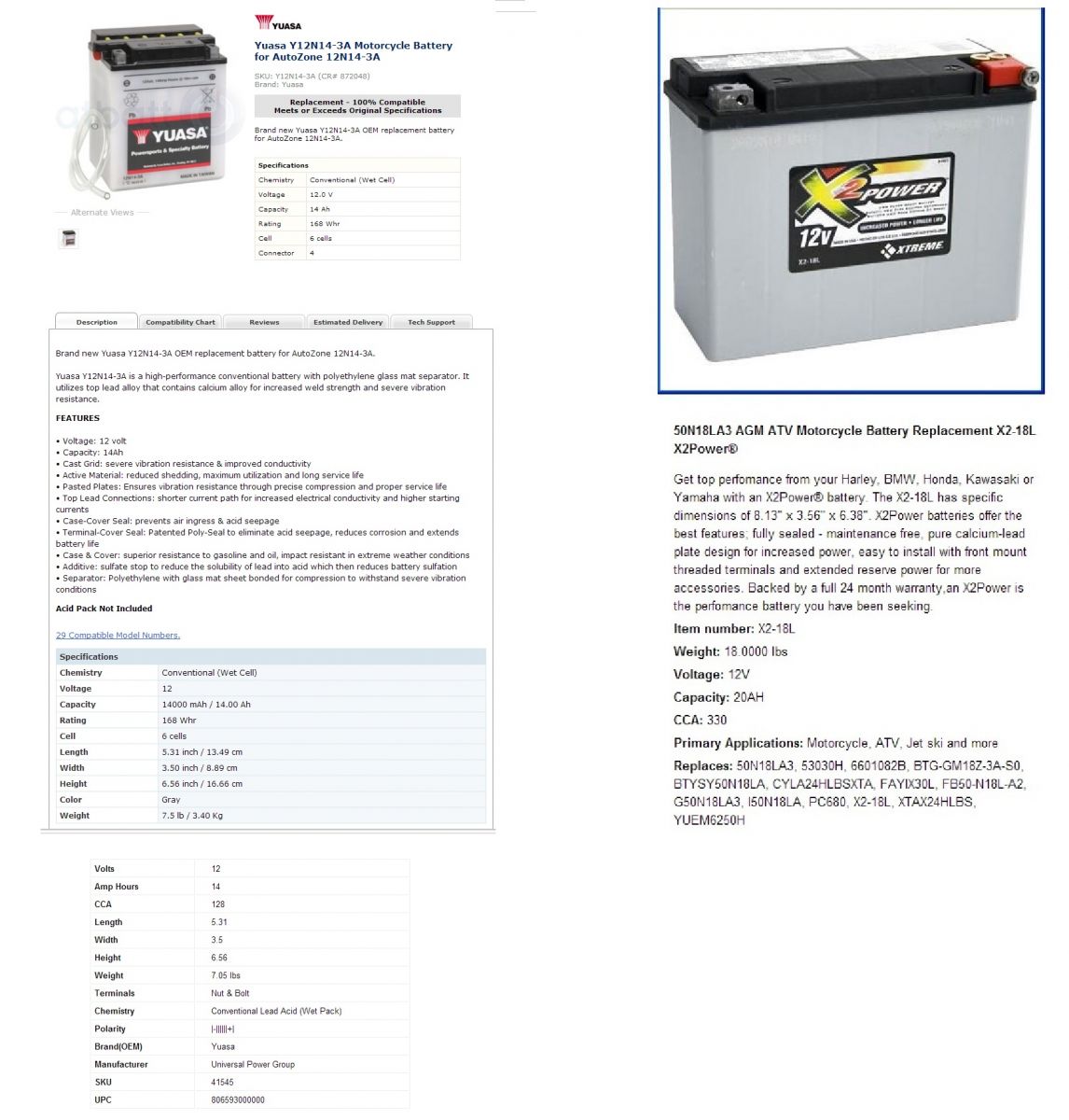

I have a 1977 kz1000 LTD. Ever since I bored the motor and put heavy duty valve springs in it, the bike is hard to crank over. I was wondering if anyone new of a battery with higher than normal cold cranking amps that would fit in my bike? Thanks

Battery Plus Stores.... Xtreme AGM batteries
NOTE: Verify/confirm/Measure existing battery dimensions before buying any new one....

I don't really get the 24v mod or the lithium alternative but that first post battery looks pretty good.
Great tip, thanks!!!
