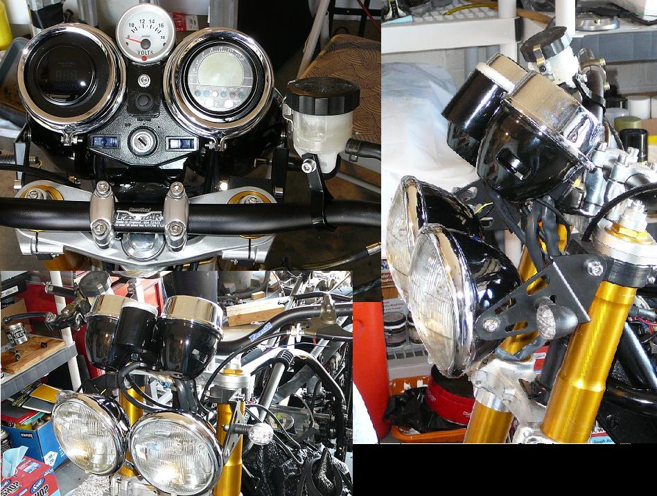

Gut an original OEM cluster kit (designed for speedo/tach drive cables)....
Mount as original designed to top tree (holes)...
Or use the top tree hole mounts with some flat plate drilled for mounting the 2 new gauges.
Or just get some basic handle bar mounts readily available on the web...
Use your imagination for how you desire it to look, you'll figure it out...
As for the two power conductors (+12Vdc and ground), after the switched ignition switch for gauge illuminations.
