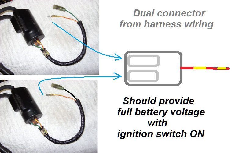

wolfey wrote: im been lurking for a few days on ur forum and its full of great info. what is the procedure for checking the ignition system the bikes been sitting for awhile i had spark but erratic them nothing were do i start
Hello, wolfey, and WELCOME to KZr! :cheer:
Could begin by checking whether the ignition coils are receiving full battery voltage with the ignition switched "ON."
When the ignition is switched "ON," both ignition coils are supposed to be receiving full battery voltage.
Good Fortune! :)
