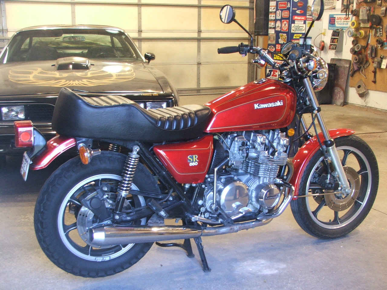

My low mileage 79 650SR starts really hard and will only start with the kick starter, won't even pop while cranking with the starter. No matter what, when it does start it idles with the choke half way on but doesn't take throttle without a bad stumble at least.. I had the carbs all apart and checked float levels, etc and all looks good. I'm wondering if there is an electrical problem and when he starter is taking current too there is not enough to go around ? If anyone has an experience with this or ideas I would sure appreciate your help. I'm soon gonna be too ld to ride this thing if I don't get it figured out soon.. Thanks, Tom

When you start the cold engine remember - choke on and do not touch the throttle. Your battery may be just a tad under-charged in which case it will spin the starter but not have enough ooomph left for the coils. This may be particularly true with your bike as I suspect the headlight is on as soon as you turn the key on. When my battery is not FULLY charged I use the kicker; it usually takes only a couple kicks at most. In fact, I nearly always use the kicker when the engine is cold; once it is warmed up the electric starter easily starts it. As far as the stumble is concerned, does this happen even after the bike is warmed up (say 3-5 minutes) and the choke has been shut all the way off? By the way, your bike is BEAUTIFUL!!! Ed

Thanks for the help Ed, I will check the battery, I kind of suspected some sort of voltage shortage. Even after it is fully warmed up it still needs the choke on to some point to keep idling and no matter what, it stumbles (nearly dies) when you try to give it throttle. I'm gonna go in and check the dwell, timing, etc. when I can find time and see if I can make it better. Thanks for the compliment on my bike. I bought one of these new and have owned three used ones counting this one. Life and family always came up with a reason why I had to sell them but I am really trying to hold onto this one. I have loved the SR's since I first saw one. Thanks again for the help, I'll let you know if I manage to fix it. Tom

Your description sounds like it's carb related to me, having to keep choke partially on when warm, has usually been carb issues on my SR
I've also never had an issue starting it with the electric start unless something else was amiss, such as something electrical that was out of order.
You may have more then 1 issue here
