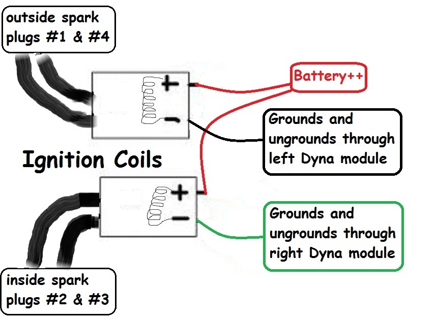

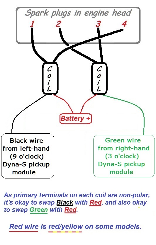

Just to be sure -- the left-hand coil (shifter side) fires the outside cylinders #1 and #4; and the right-hand coil (brake pedal side) fires the inside cylinders #2 and #3.
The left-hand (9 o'clock) Dyna-S pickup module signals the left-hand coil; and the right-hand (3 o'clock) Dyna-S pickup module signals the right-hand coil.

Thanks Patton, don't I feel stupid. lol
Must have mixed up wires over the winter.
